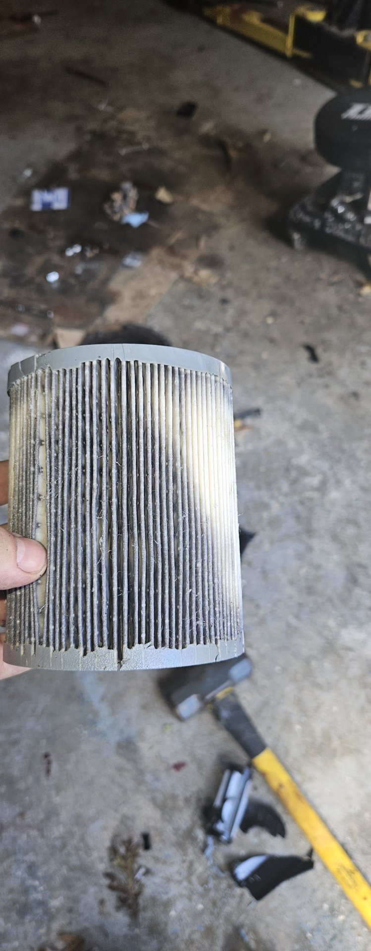

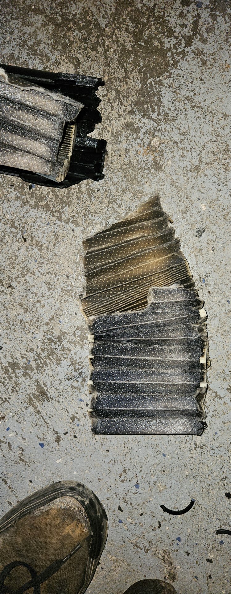

I did some research and found that biological material in the tank could be causing the filter to clog. I broke open the original filter, and it was covered in black (I couldn't really tell if it was slimy or not because it was soaking wet, but I could probably say that it was likely slimy). The replacement filter was also pretty black after about 1.5 hours of use. I have no idea if this is normal, but I'm assuming it's not.

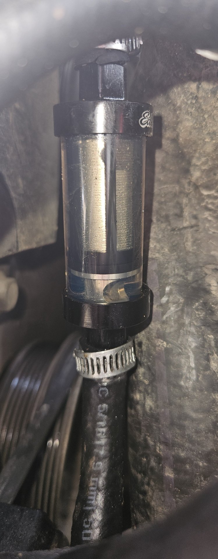

I decided to get a good inline filter as a pre-filter for the Bobcat filter, so I wouldn't have to keep spending $100 on Bobcat ones. I bought a second replacement filter and a pre-filter, installed them, and it fired up. I used it for a couple of hours, then drove it home, turned it off, and went to lunch. When I returned, it just cranked. I managed to get it running with excessive priming by draining the fuel lines, but it only lasted about 25 minutes before quitting. So, I'm back to square one: a third clogged bobcat filter, I suspect.

Any help would be greatly appreciate! Please and thank you! I've attached the few pictures, a busted the bobcat filters open. The first filter is the one that was on it when I got it. And the second was one that I put on it that maybe saw 2 hours of use.

I believe that you might have the dreaded diesel bugs, they reproduce in fuel that has water in it, a treatment it required to kill them off.I think power source has a good treatment available most everywhere. you need to take care of this asap as the excreate a acid that pits metal parts. I would drain off what I could and treat fresh fuel for what you can not remove. and change them filters often till it cleans up.

I am not familiar with the bobcat fuel system and also unsure if there is a way for soot or something to make it's way back until the fuel system and clog the filter, it seems unlikely to me. Especially since the contamination is coming in before the filter from the tank. All of the diesel that I've drained out hasn't looked black or anything either. I did have a glass pre filter hooked up before the bobcat filter and did see quite a few things floating around in it but nothing black, it was only 100 microns so the excrement was likely making it past it.

well as a prefilter that glass filter will be ok but the micro level of those filters is not to good,with the newish diesels you need to find a finer filter than glass one and it wont get much in the line of water removal. so keep a good eye on it and do not let it fill up to much.
