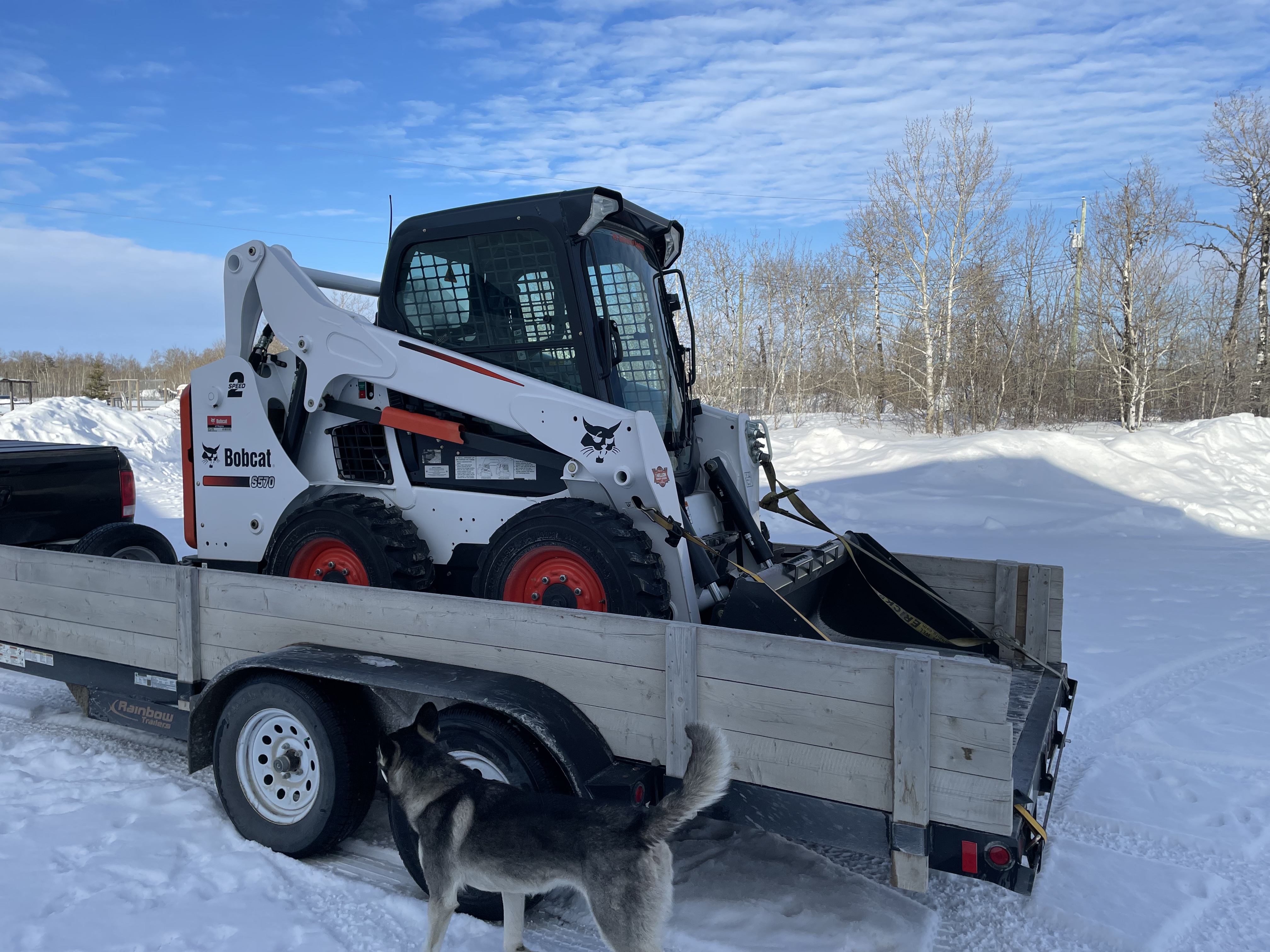

Picked up a 2012 S570 with an aftermarket rear view camera system - wireless camera - that did not have the camera itself wired. Tested and works great otherwise. I’m looking for a proper location to provide ignition on/off power to it at the rear of machine so camera stays on when machine is on. My manual is on order and shipped but sees to have been shipped to someone else and working to get that sorted with bobcat. If anyone has info on a safe location to power it that would be appreciated.

you have three options, #one wire the camera to the back up alarm, and the monitor to the switched power out of the key switch.(this will be the same on all three)# 2 wire a single switch to the camera in the cab so it only comes on when the switch is on. #3 run the wire to the switched power out of the key switch and the camera will be on when ever the machine is working.
