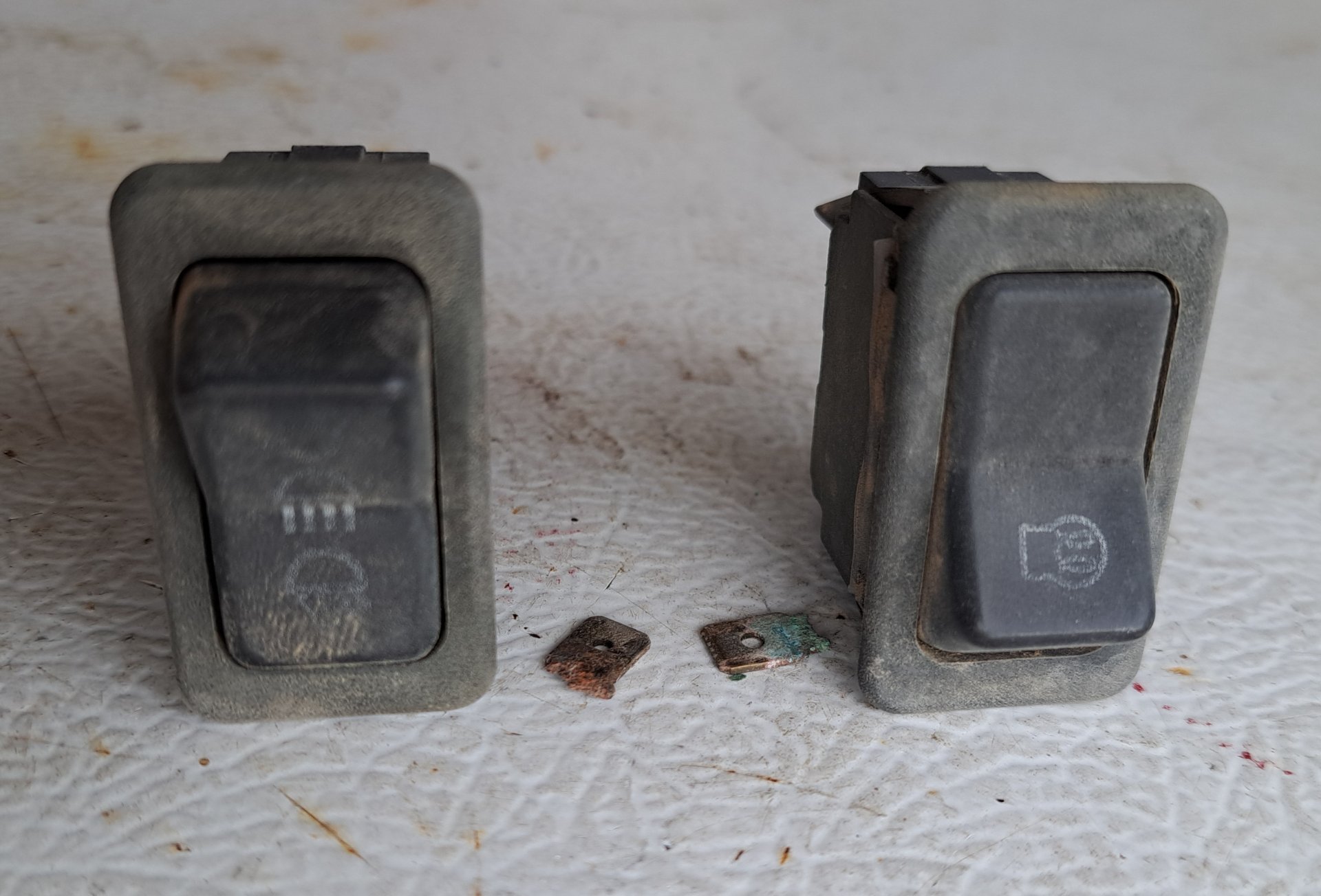

Ok,
Issue Just started. No volts, temp, fuel, or hour gauges.(top right gauge cluster) Dead in the water. Machine starts, drives., All normal. Lights work too. All fuses good. Unbolted gauge clusters (both left & right) nothing obvious seen. Tilted cab up, nothing else obvious on wire harness . What should I check or test next? I'm a bit stumped.

Did you checked for voltage or ground by the gauges?
No, Thunder & Lightning really bad, so I took a break. I will check that after the storm decides to pass. Thank you!
Todd
OK...

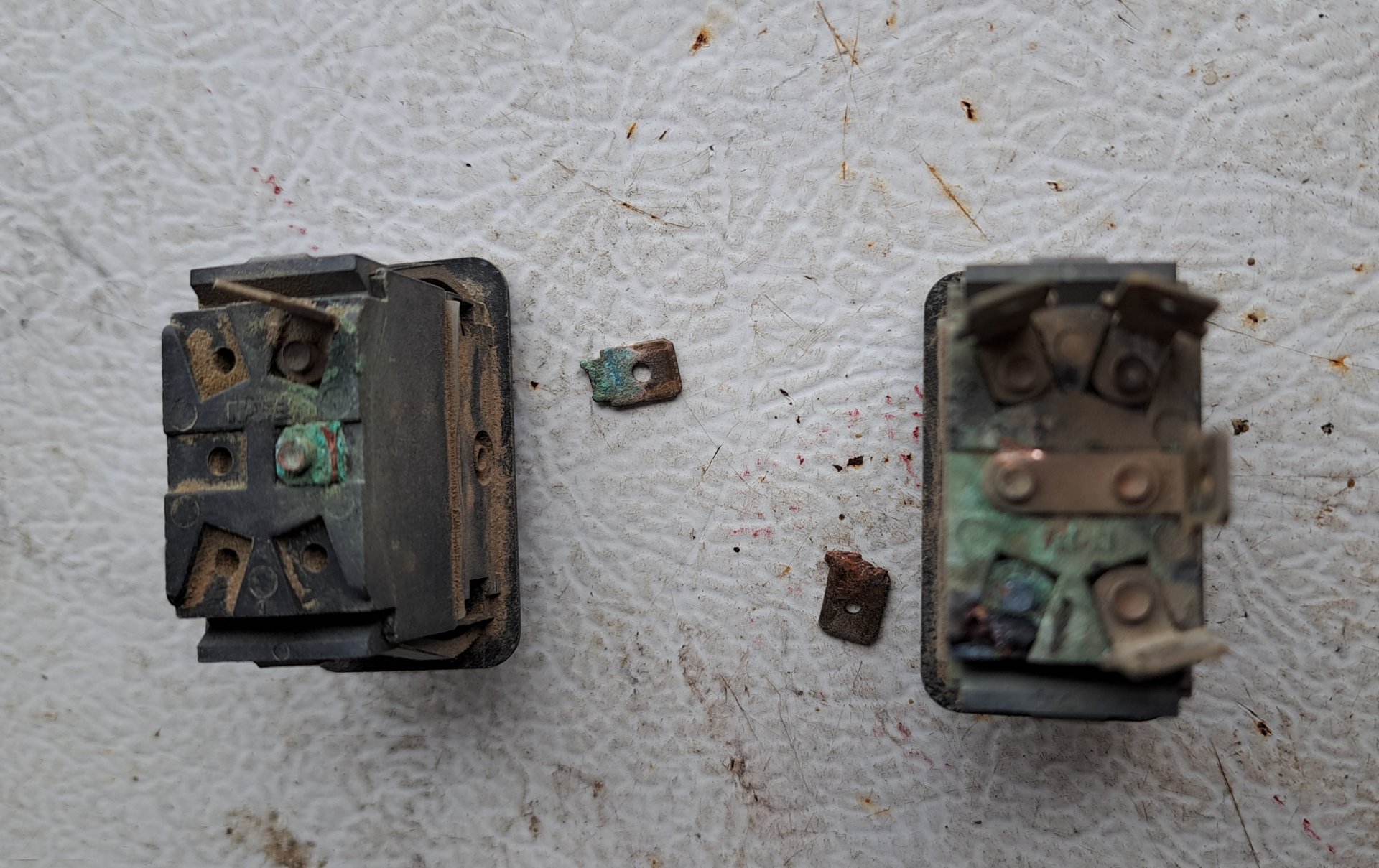

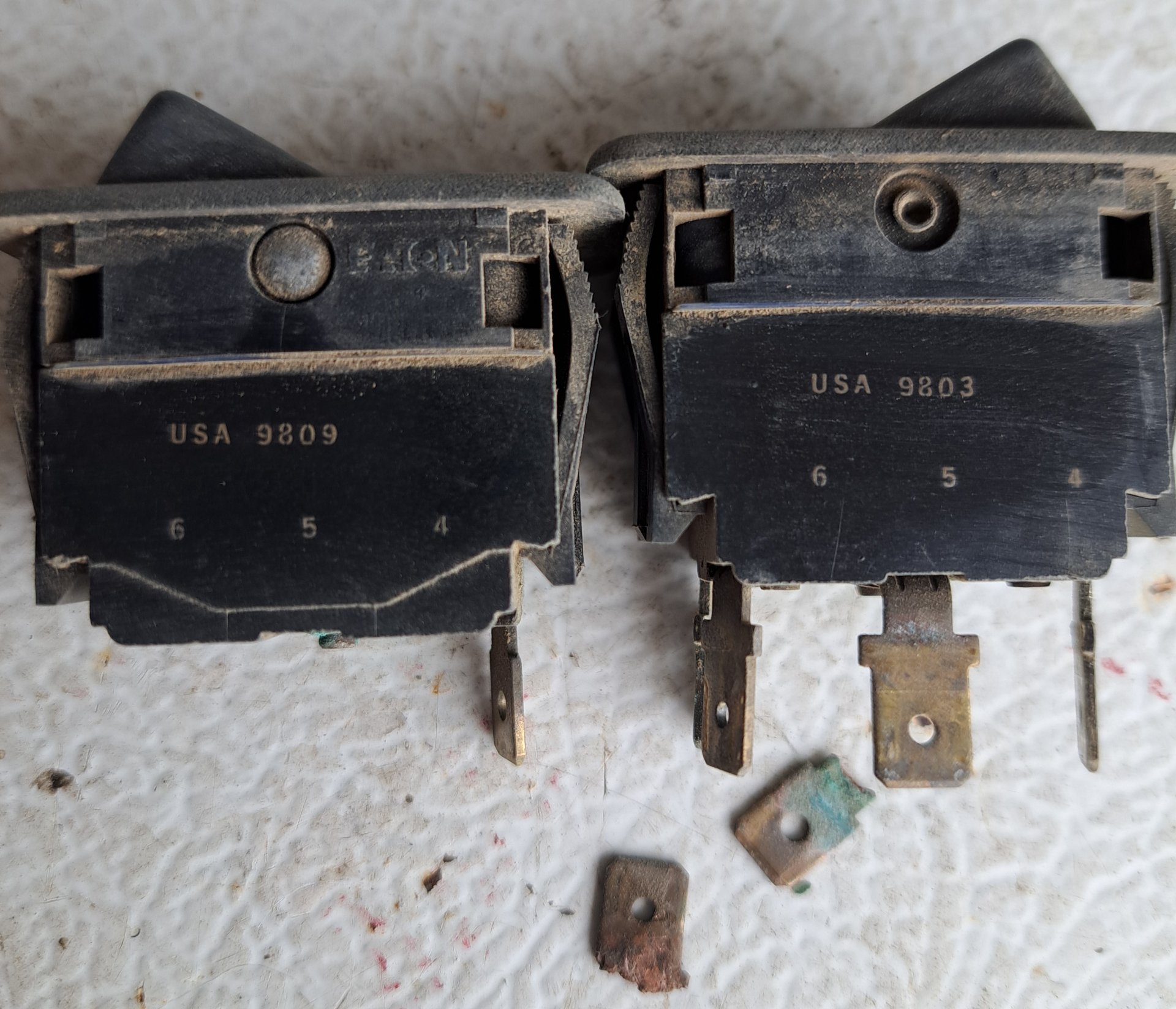

Figured it out after Lightning storm.
On the left Gauge panel the Glow-plug switch was broken (which I never use). And the Light switch was broken with a small amount of charing/melt around the connector.
Once all pulled apart and broken plugs removed from the connector I re-tested and All Gauges work now..those are original stamped made in USA switches probably from 1999. She has over 6,380 Hours on her!
See pictures.
Todd
