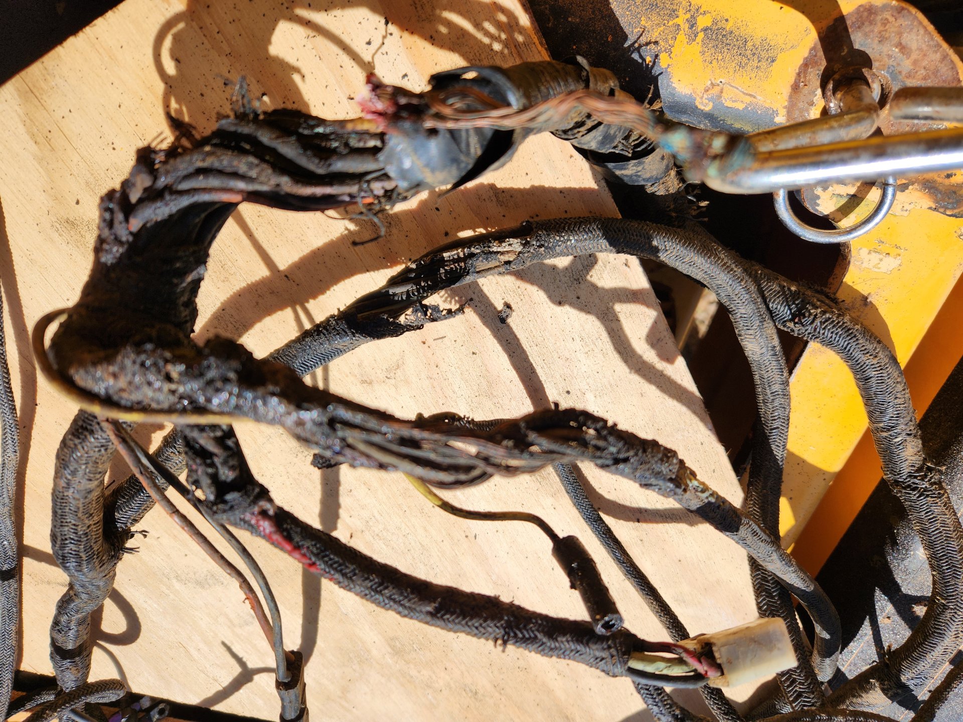

Looking for a wiring harness or someone to repair one for a 2040 Mustang skidsteer
deer 1999.

Looks like the engine harness, that one i dont think is available anymore, the rops harness is.
what i have done is used the harness for a late model 2044. You would have to replace both
harnesses, there are u few minor differences but nothing that takes any big changes
