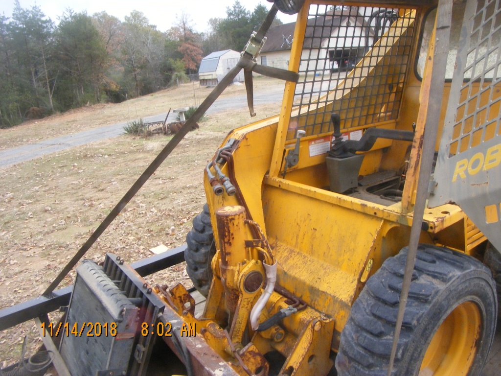

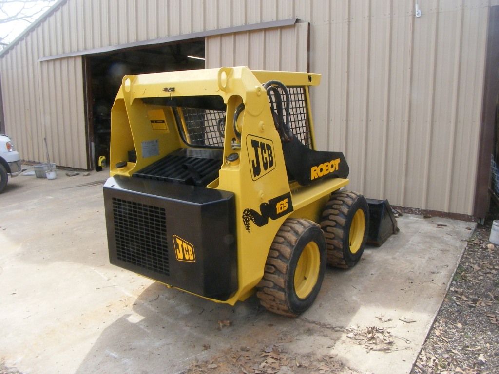

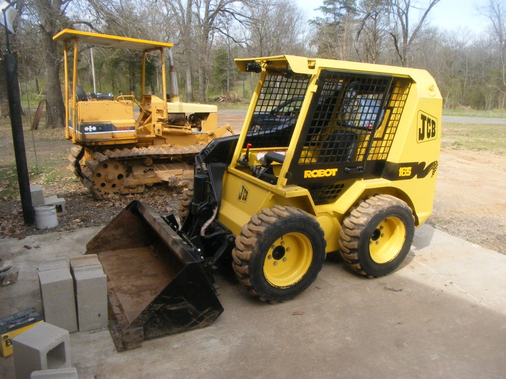

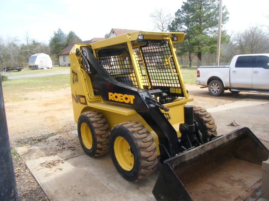

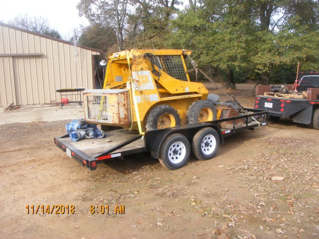

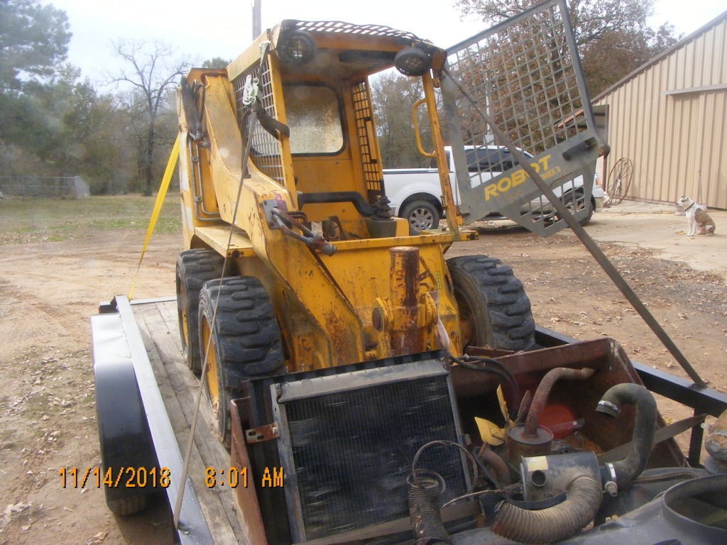

We Bought this from a salvage yard in Texas, blown engine and had been through a flood.
Areplacement perkins was not an option, $7,000 for an engine with 3,000 plus hours was not going to happen. An adapter plate, more than one mod including a rebuilt radiator and fabbing a fan shroud (we all know there was much more) and a Kubota V2203 is getting it done.
It has since thes pics lost the 10" wide tires and now has twelves

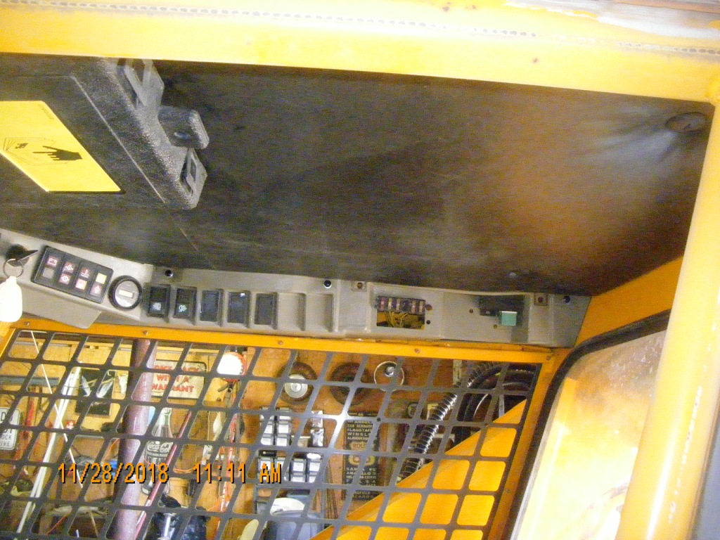

Failed to provide cab pics. The ceiling padded (as if) panel is recovered and owners manual box reinstalled. The original owners manual is still inside.
