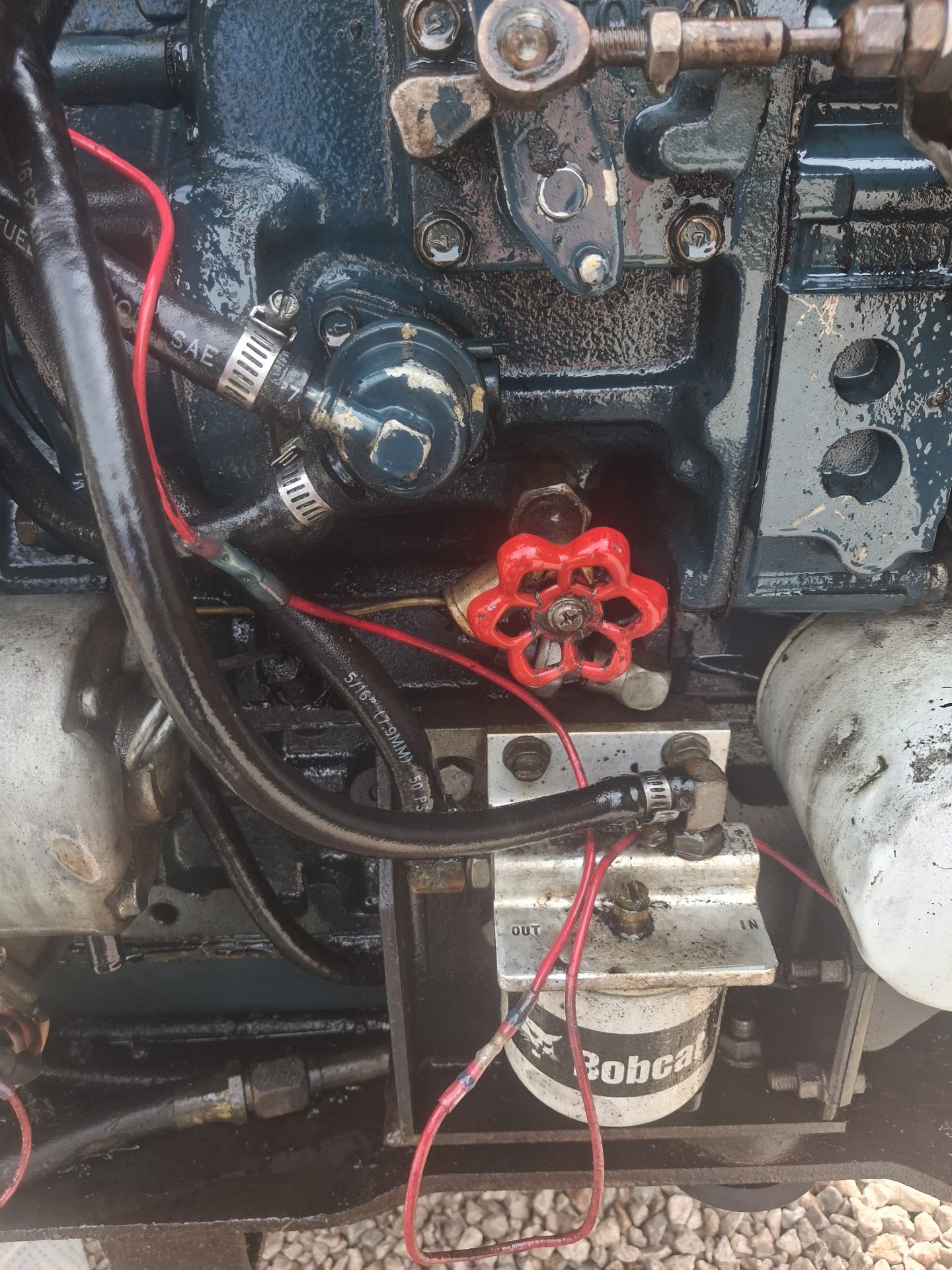

I picked up this 763 a while back and have used it a little. It needs work but it seemed to run solid - until yesterday. I started it up and left it idling for about 15 minutes to warm up. When I came back the machine wasn't running. Cranks and sputters once is a while but will not burn & run. Has a new battery in it and the starter isn't lazy. It is not out of fuel. The previous owner threw a universal 12v fuel pump on it at some point rather than repairing/replacing the lift pump. The universal pump is pumping fine. I have fuel up to the injection pump near the head. Before I go any further what else should I be checking? Also - take a look at the attached picture and can someone give me their best theory regarding the water spicket valve screwed into the engine? No hose hooked to it. Thank you
I've not checked the key switch. What will I be looking for there? It turns over great - just sputters once in a while but will not run.
that spigot is just to make draining coolant easier as a hose can be put on it for a bucket ,I assume. Since this is machine kinda new to you ,,Pull off the outlet of the electric fuel pump and place a hose on it and put hose into a clear glass jar ,turn on pump let it half way fill jar and turn off, let fuel sit for 5 min. and see if there is any water in it that has seperated out. If by chance your fuel filter has a drain in the bottom of it a sample can be pulled from there also. This will let you at least know the condition of the fuel systems tank contents good or bad.
