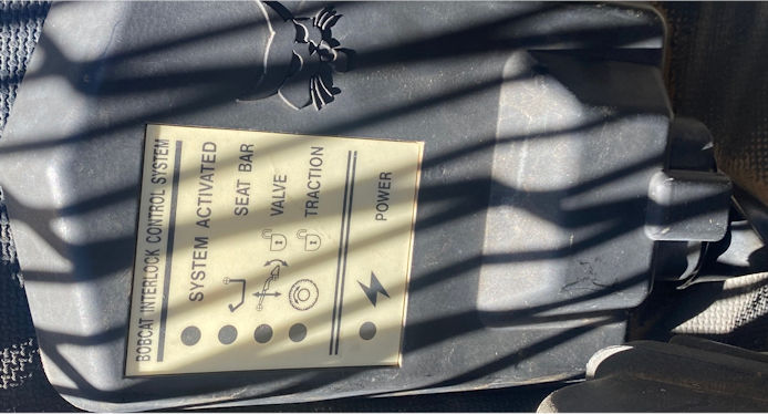

Bobcat 753, year: 1996, sn 512 729488, BICS controller: 6680411. There are five LED indicators on controller. When sitting in seat with bar down, Bobcat running, everything apparently normal, all controller indicators are on solid except for the "Traction" LED, which is blinking.

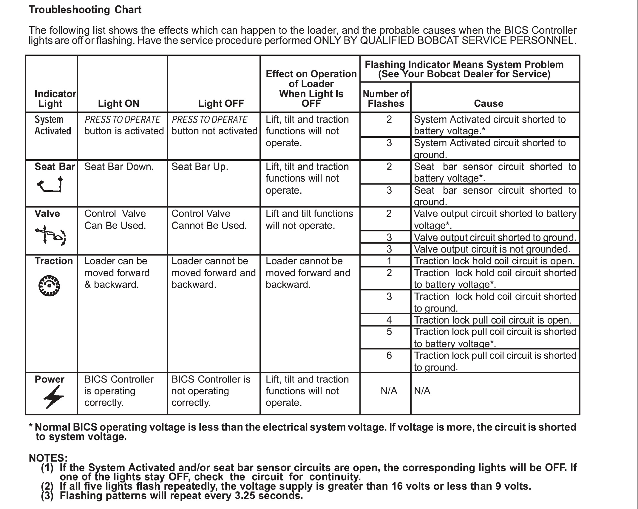

I've just started the troubleshooting process. But can someone tell me whether the Traction LED should be solid or flashing?
Is there a guide to interpret the meaning of those indicators?
Thank you,
Frank

I found the answer to my question. I'll attach it here in case the error codes can help someone else.
    811.2 KB
