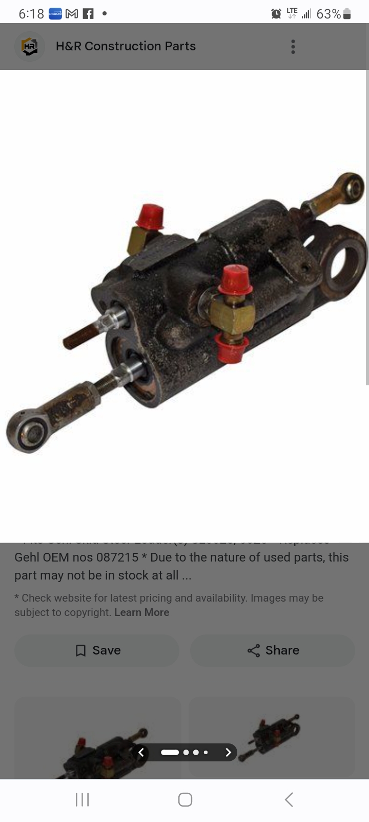

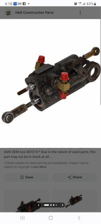

Looking for help locating a hydraulic boost control part number 087215 for a 1995 5625sx skidloader working or nonworking have searched all over the internet and found nothing any help would be greatly appreciated
Here is a pick of the part

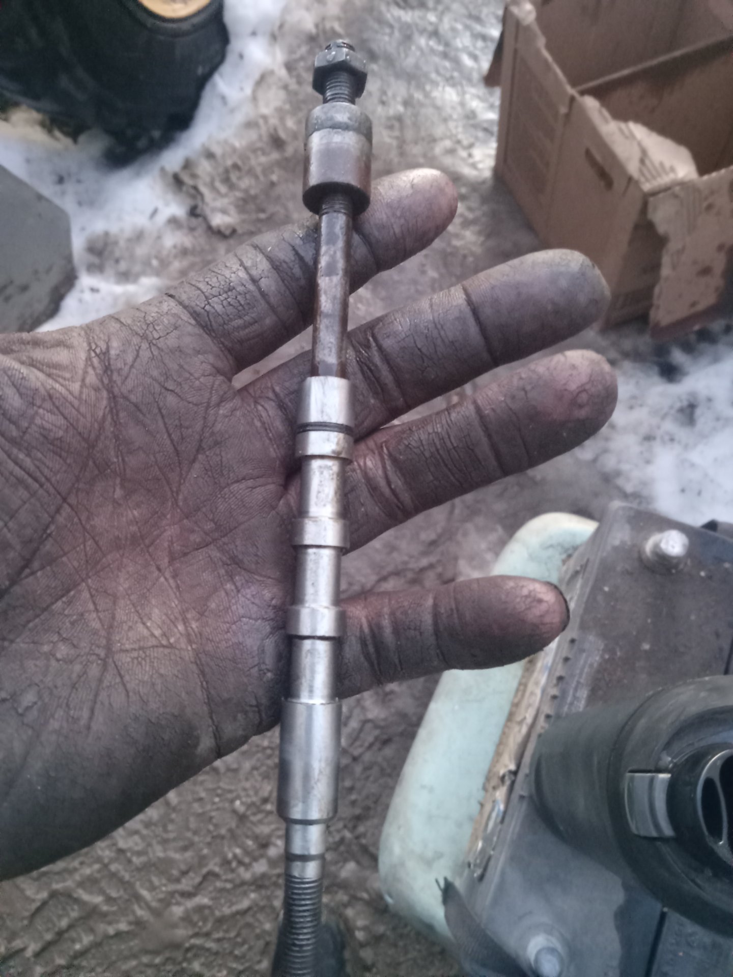

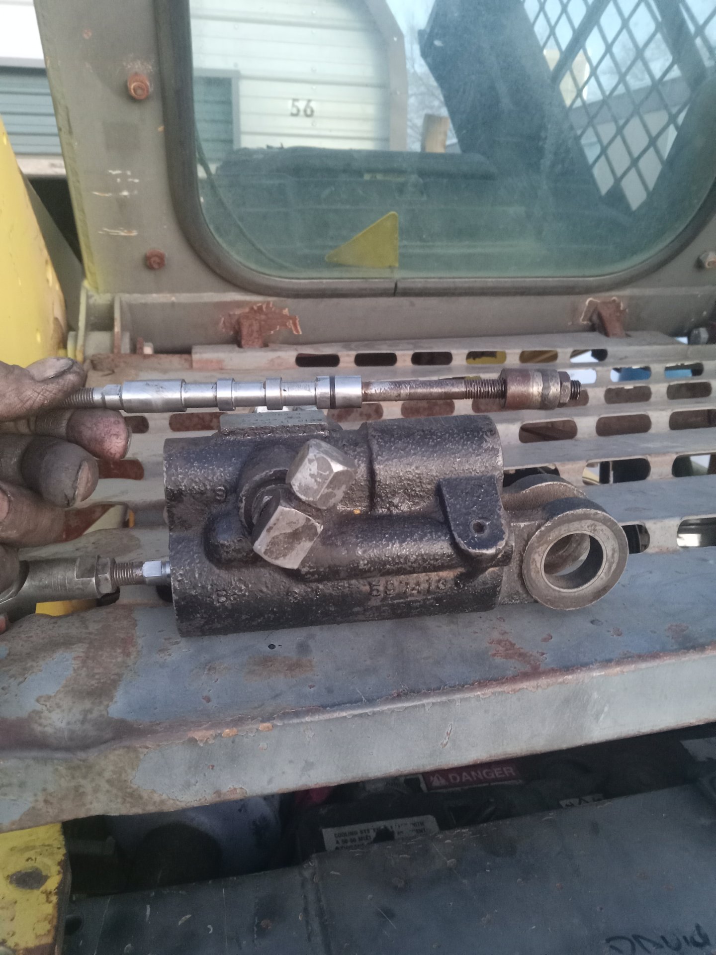

One control boost is missing the shaft that passes all the way through the part .I will try the info u gave me I would be willing to purchase a non working unit just to replace the part that is missing on my part.This is how I bought the machine and I believe eighter they lost the part or the part was brokin
Ok I'll give it a shot , but I'm pretty sure I've already called them and they are saying that the part is obsolete. I did get ahold of one of the previous owners and he said he was operating the machine when it went down.said he couldn't find the shaft that fellout so he pulled.both boost controls out hoping to find a machinist that could replicate the part, but said no one new how to take it apart without ruining the good part I can send a pic later today of the boost control that needs work and its the shaft that has threads on both ends.thankyou for your help ull send a picture of actual part today
The shaft is the part I need and the removable spacer on the end just need those 2 parts and I can run it back

Yes, more than just a shaft as described in the parts manual.

Sn# 9449 I noticed 2 shock absorbers just to the right under the seat as you are looking in from the front .I showed the machinist and he is calling the.shaft a spool so I'm leaning towards having him make the part.it would be nice if I could purchase the spool only
Serial number is 9449 email address is [email protected] .I showed the machinist the part he is calling it a spool.He also explained how he would have to turn the spool .more complicated than I realize.Im going to take him the parts today for.him to replicate a d I. Looking at buying 2 seal kits.id feel more confident in purchasing the spool alone but I just can't find the part in the diagram or online anywhere. So I'm going to put my trust in the machinist today
Well John, depending on the cost, you prolly have made the right decision.
