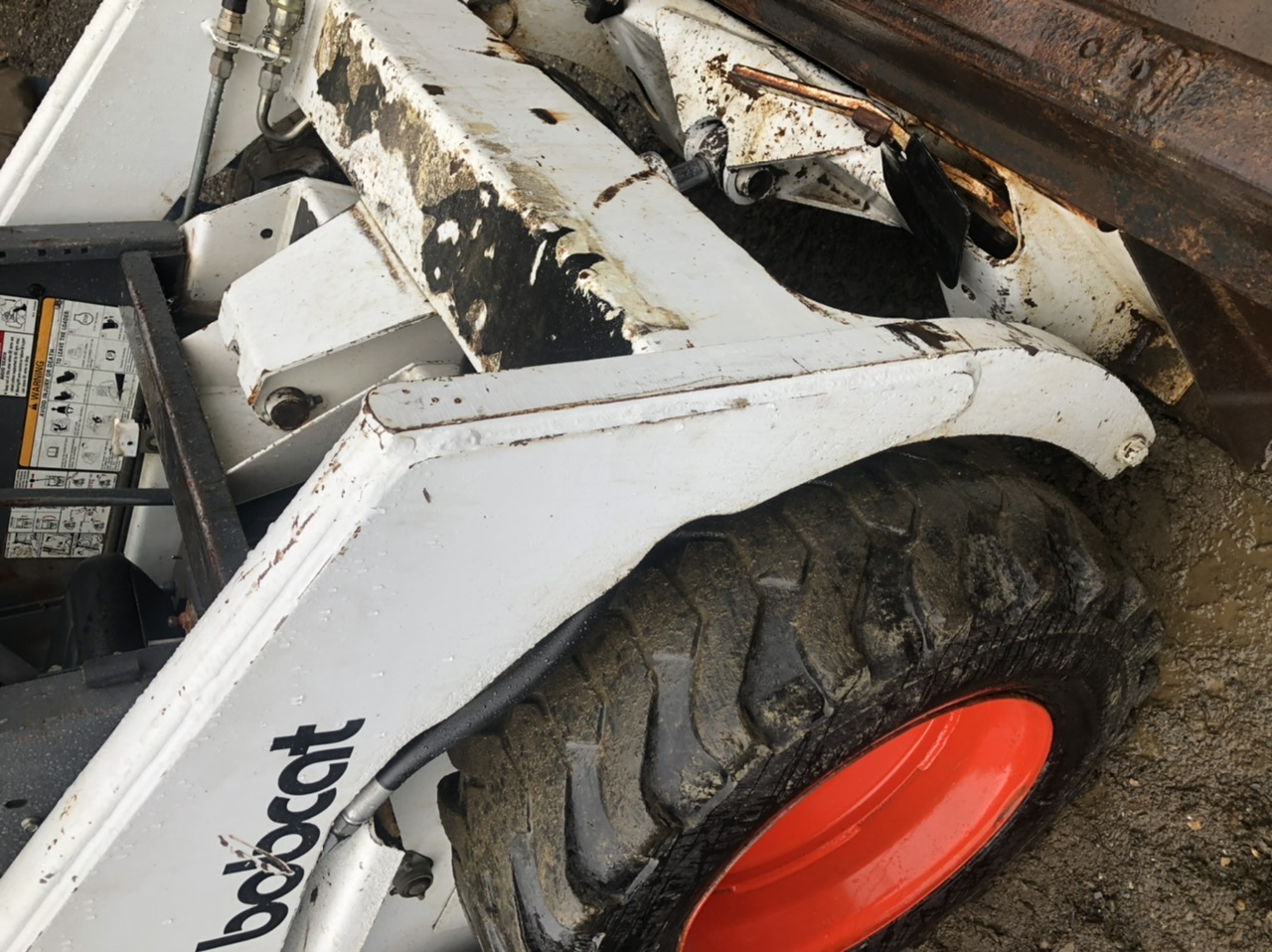

Can some tell me what the original hose between the hard lines and the bucket tilt cylinder? Mine appear to have been replaced and seem to too large to fit up into lift arm; they drag on the wheels. My local Bobcat dealer says the parts are no longer available and the parts list just says "Hose"
There should be a hose retention plate that goes over the hoses on the lift arm to keep them from drooping down. You should be able to see the bolt holes. The part number is 7351080.
Bobcat still sells them new.
I may have a used one somewhere in my garage but I'll have to search for it if you are interested.
Thanks for the reply; I'll send you a PM
