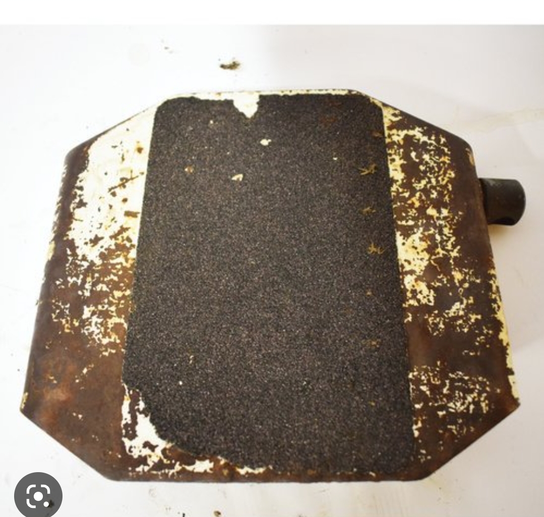

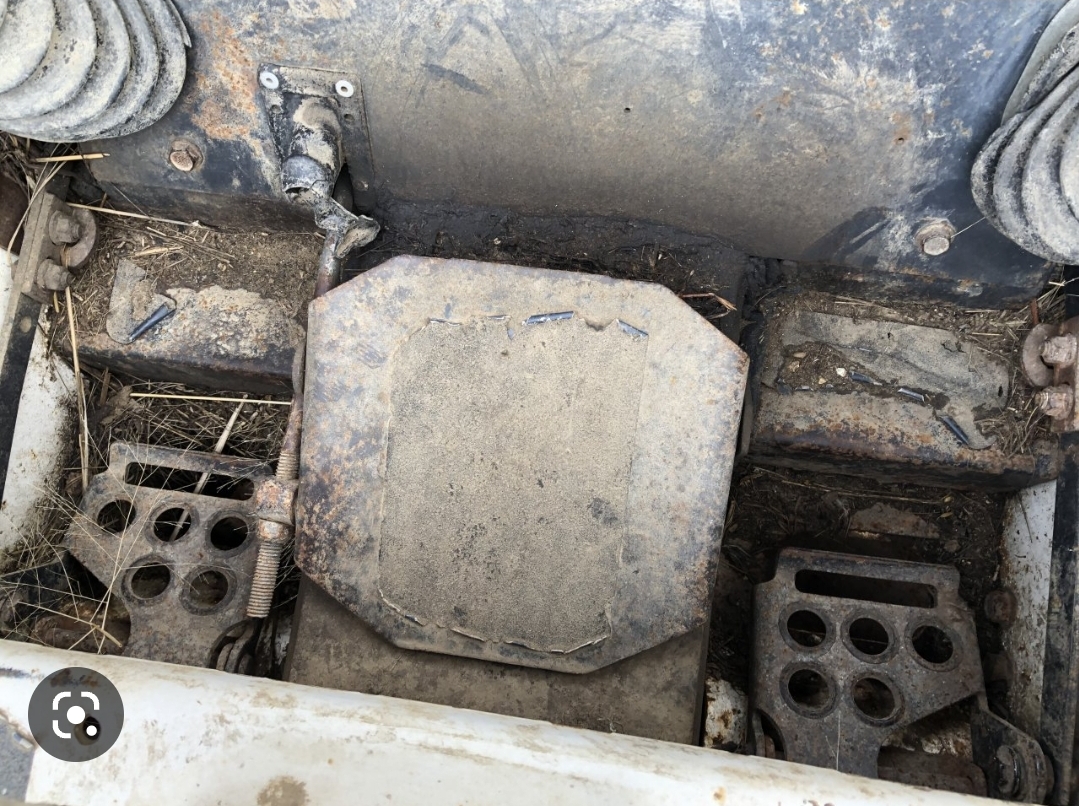

Hi all! First thanks again, for all your info!! As explained, this is my first wheel loader / bobcat / clark. After all your infos I started to dig into this thing...
1. I found out, that the "funny noise" I heared seems to be very common and kind of "normal".
2. I wanted to be sure that there is no locked break or that the drive chains are over thightened / or even to loose. So I started to get into this old rig... what I found inside the bobcat was a dark, oily, sticky, slimy, rusty "grave", different rotten hydraulic hoses, a leaking hydraulic oil tank and the blewn tilt cylinder....
I couldn't find any kind of break (🤣 think one of the former owners solved all possible break issues finally). ...so it became clear why there was no break pedal....
Only thing i could find was that there was the double amount of oil in the chaincase which has to be in there. > for me could be one of the reasons why this rig was so oily.
But apart from this, the heavy corossion, a blewn tilt cylinder and rotten hoses there was nothing which looked not OK, and at least the thing was running and operating. So I disassembled, the rig, cleaned it, grinded it (so far as possible) painted it, changed the tilt cylinder and replaced all rotten hoses. I installed new aftermarked fuel tanks and put a new hydraulic oil tank on. Now I just started to put all pieces together again.
What I am wondering now is, how to vent / bleed the air out of the hydraulic system?? Any Ideas? Many thanks in advance!

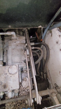

Thank you so much! I fear you could be right. I couldn't start till now, because all these little bits and pieces which "want" to be repaired or improved before putting it all together again... but what I can already say is, that the pump is leaking somewhere at the front end, and only by the pressure of the oil in the reservoir. And under the loader is a large oil puddle again, too. I just noticed it when I was in the shop early this morning, when I pepared my truck for work. I didn't have had the time to take a closer look, but it was enough to make me sad....
Is this a common thing, that these pumps are leaking "somewhere" on the downside of the pump. Could this be fixed without pulling the whole pump again🥴. Has anybody any experiences?
Well… I had a similar sounding leak and ending up replacing the seal on the pump shaft. It was easier to pull the engine than the pump, especially since I already had most of the engine components taken apart for repair. There is a very good YouTube video by a guy who did the same repair. I'll see if I can find it and share the link.
Check out Savvy Sprocket on YouTube he goes through the whole pump shaft seal replacement. Also a good idea to take apart your port block to clean out the filters and change the orings.
Thanks, the "Savvy Sprocket" story I know. I pulled engine and pump. The pump shaft seal seemed to be fine. The whole area (backside of the pump, engine flywheel) has been dry and (in competition to the rest) clean. Now, so far I could see this morning, I have a puddle on top of the chaincase below the port bolck and (I think it's called?) the vene pump. But I will have a closer look by tomorrow. My big hope is that I can fix it, without pulling all completely out again... I am totally allone and haven't got the right space and equipment/tools to do this stuff. I pulled the engine and put it back in again allone with my bare hands and a car jack - and I am happy that it worked and that I did not break me any bones or my back.... I willingly would avoid to do it again... especially if I worst case would have to take out and to seal the drivemotors, too. I bought this bloody rig to build a driveway.... since I bought it I am working on it and the building permit is running out soon....😨 it's a mess...
