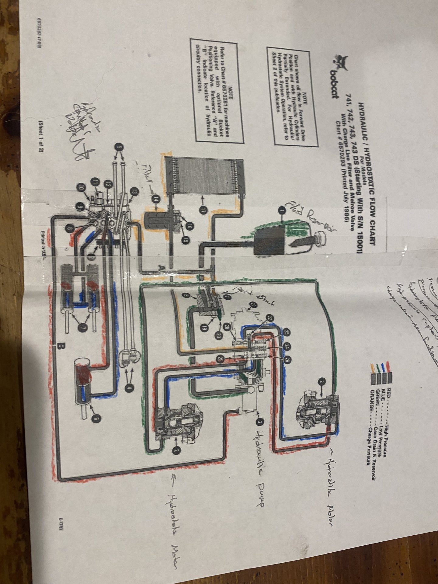

Is the motor and hydrostatic drive clean from dirt and oil buildup? This will keep the heat in and cause it to overheat. Also check the hydrostatic pressure relief valve and make sure is opening up when there is too high of pressure on the hydraulic system. This too will cause overheating.
The engine in clean but there is quite a bit of grime built up around the bottom of the engine. How would I go about testing the hydrostatic relief valve? Also where is it haha
On top back of the hydrostatic pump is a pressure switch with two wires going to it. One wire come from the wiring harness and the other goes over to the pressure relief valve, which is in the port block.

This is NOT a hy-stat problem. IF the oil cooler fan is not working the hy-stat oil can get too hot, yes, but that has nothing to do with the relief valve. Rarely rarely rarely rarely do you ever hit relief in the hy-stat circuit other than momentarily when you grab a lot of stick too quickly and almost kill the engine. To test the hy-stat relief you have to first engage the mechanical travel lock and then (slowly) pull in some control stick. IF the engine doesn't die the system will hit relief pressure and the relief valve will open. Do this in HIGH range only. If you do it in low range you risk breaking the mechanical travel lock.
You do NOT have a hy-stat problem. You have an engine over heat problem.
