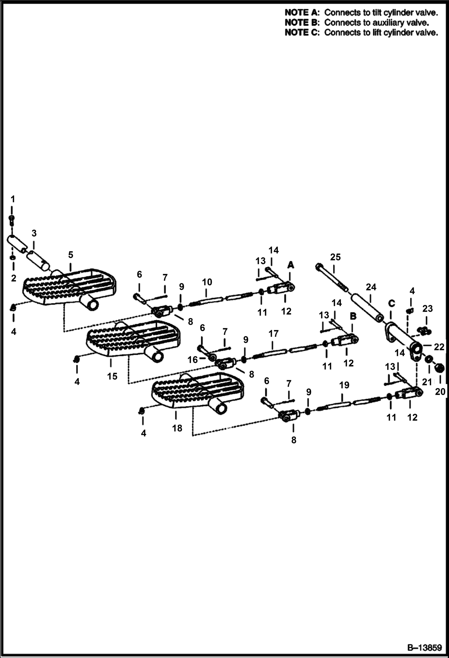

Ah that's what I been looking for. Super thanks. I've got 3 books and not one has this in it. Super. What's missing is the link (#23). I've been pulling my hair out.
If you go onto the above website you can find the actual bobcat part number (6515186, of course you should verify this by using your SN on the website) and then go to:
shop.bobcat.com
and see if the part is still available or not. (It is…$15.19). You also get a photo of it. I've been surprised at some of the older parts that they still have in stock. Also, some of their prices are very competitive now, unlike the past. But of course there are still a few things on there that I just don't think they want to sell since the prices are stoopidly high.
This part is a simple chain link and you may be able to find it elsewhere cheaper. However, without knowing the exact size, or having an example to show or measure, it may actually be less of a headache and a time saver just to order through shop.bobcat.com or get it through a dealer.
