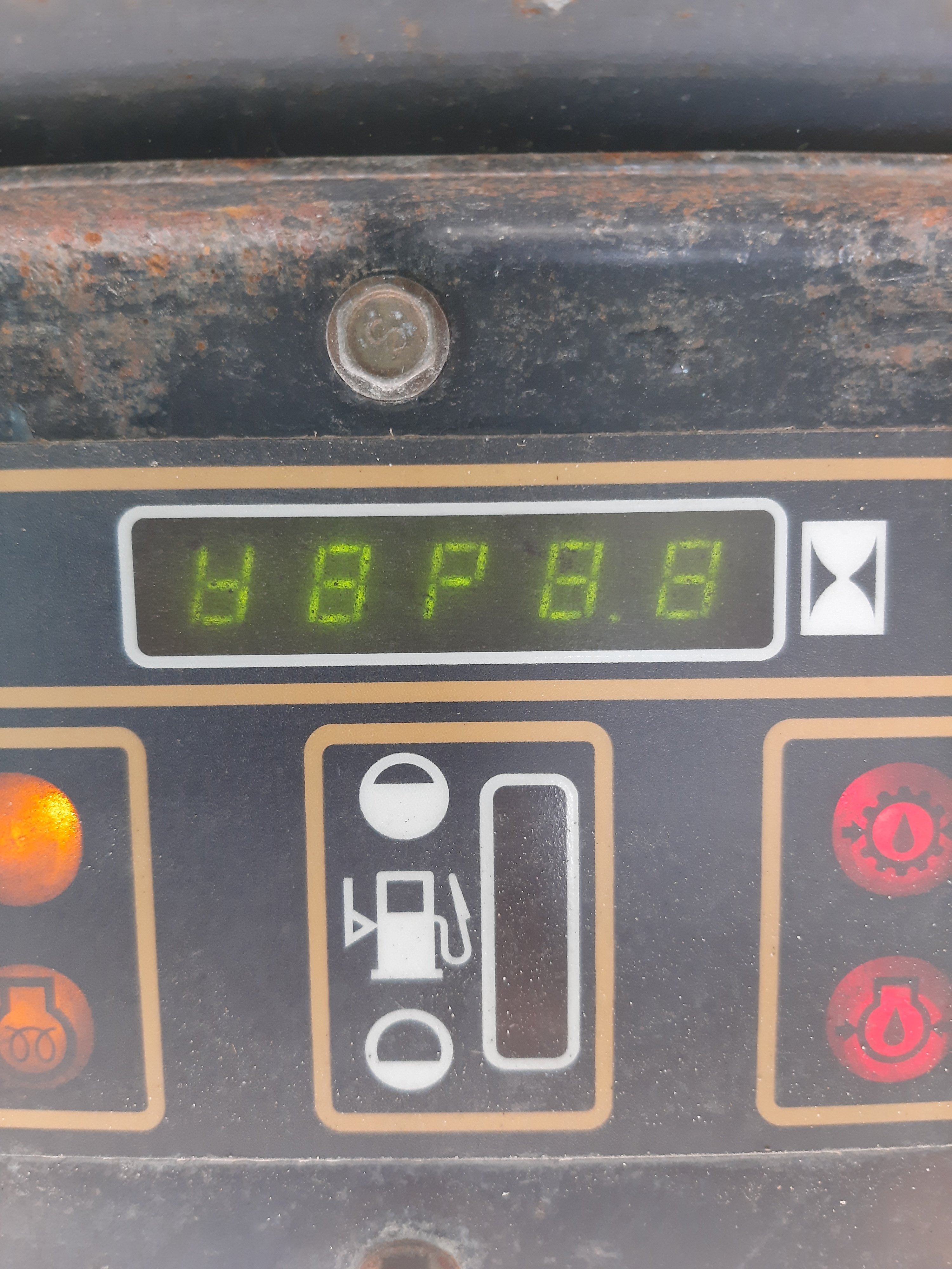

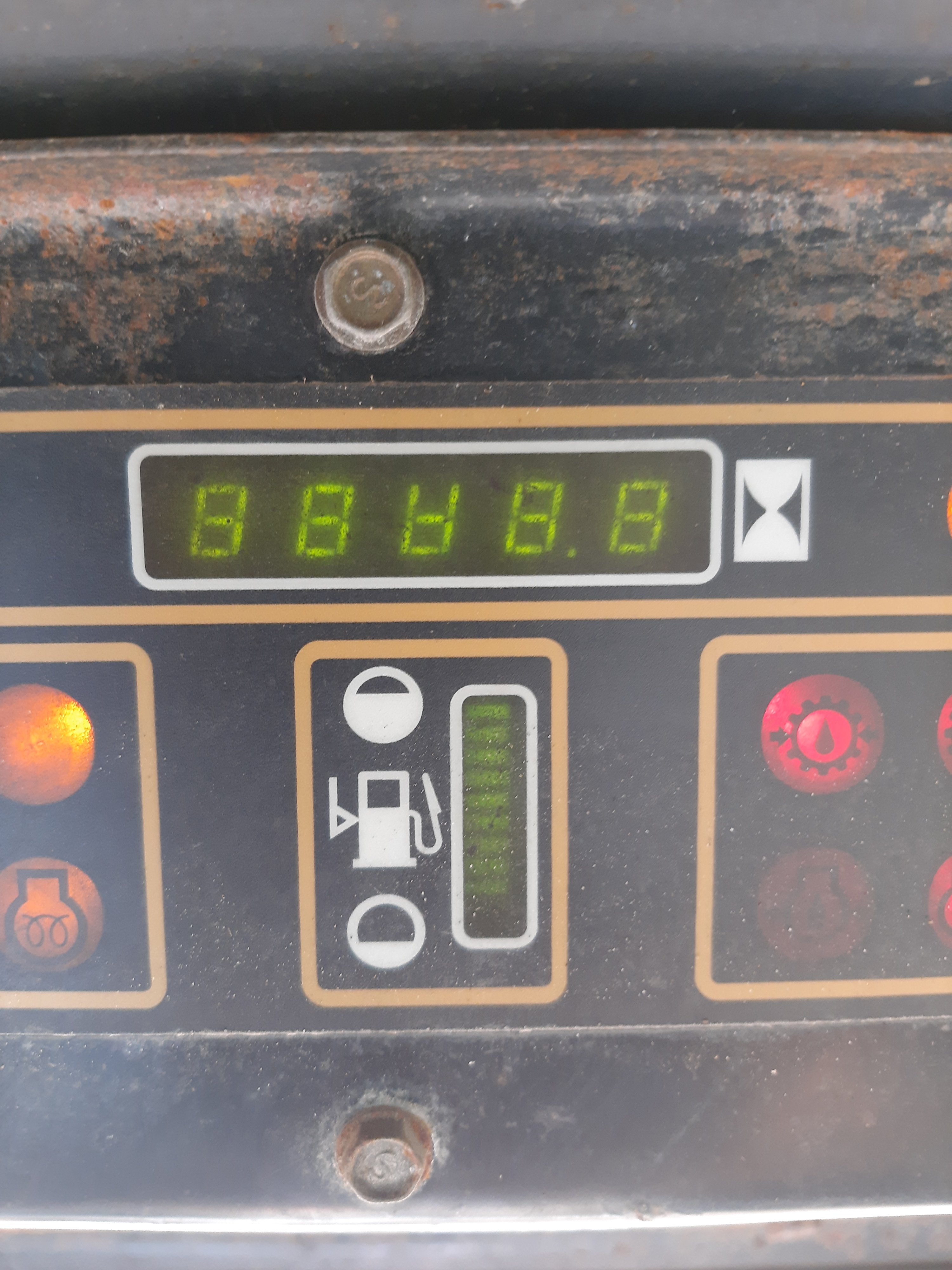

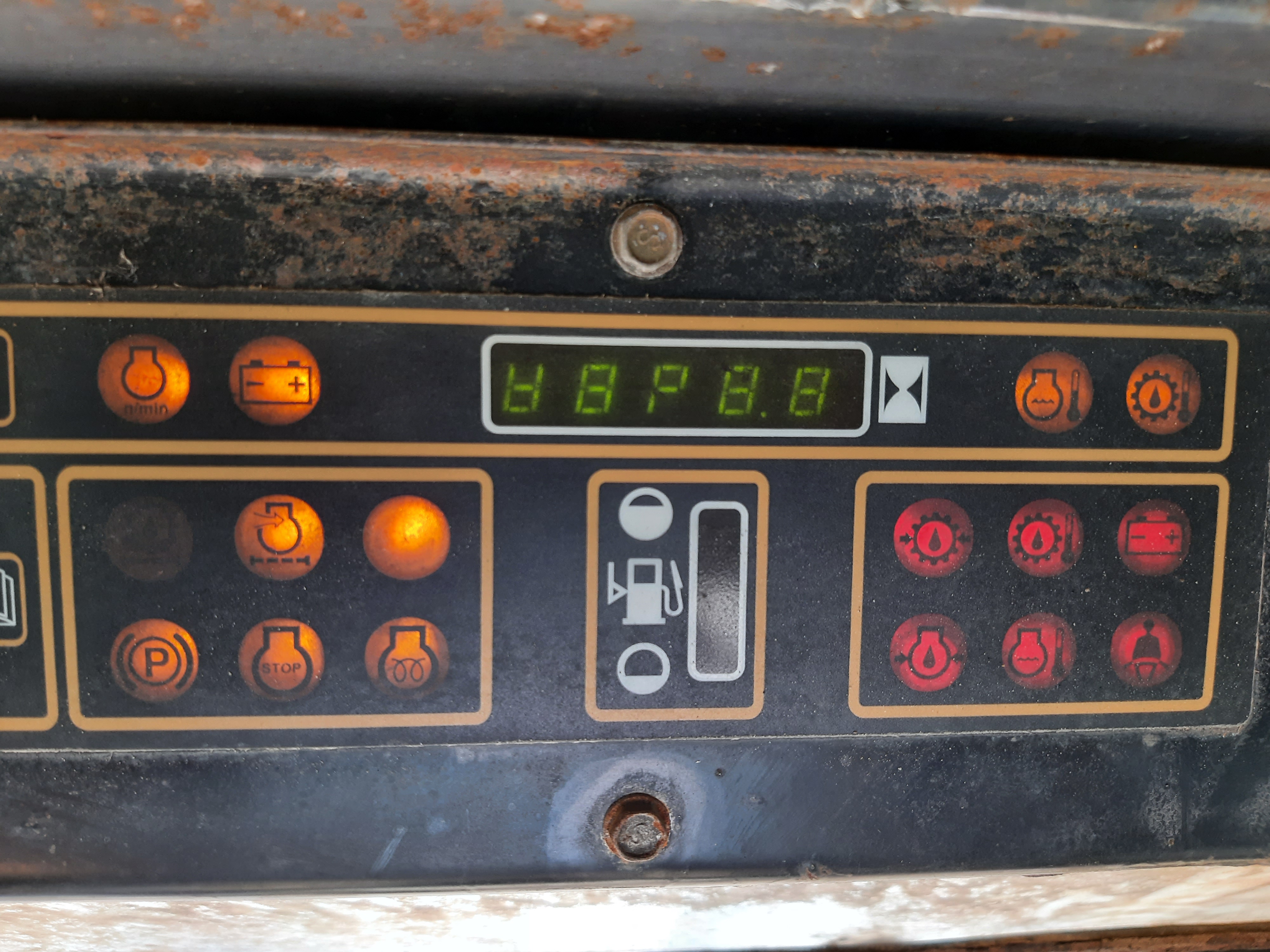

I have a 01 LS190 , used last week no issues , got in it the other day noticed the display was lit up like a christmas tree, and seat belt indicator noise stayed on after start.
I shut machine off ASAP. still starts in service mode and run, with hydro locked out (no boom or tilt) went to restart with no display still runs and drives. I have checked all cab and accessory fuses with a meter and all test good. Seat switch and seat belt have 12volt in and 12 volt out. Display is intermited on lighting up. I can send 12 volts to lock out solenoids and they release boom works ect. but cannot get 12 volts from harness. I will attach the 2 display board pictures to see if anyone knows what they mean . TIA
