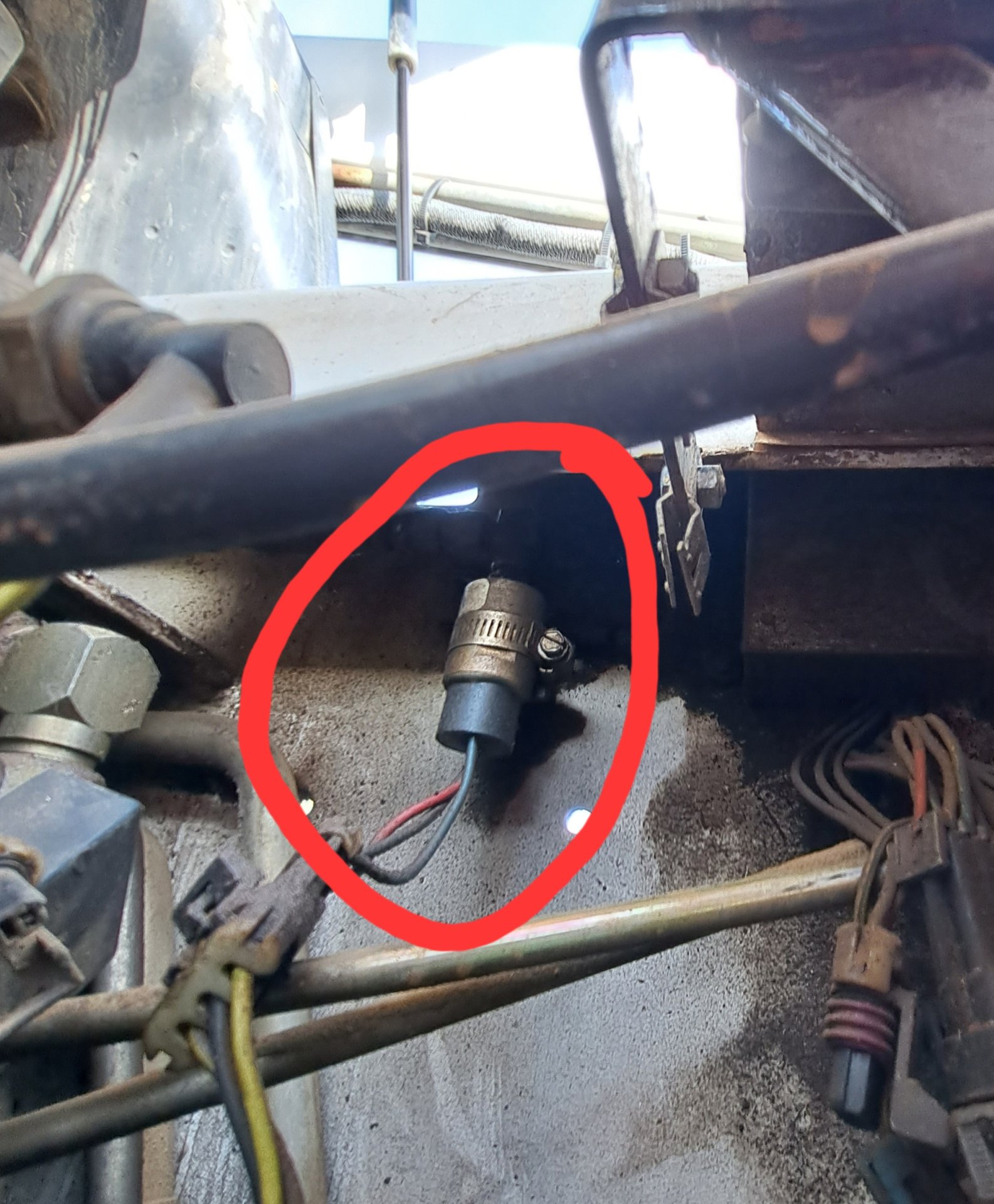

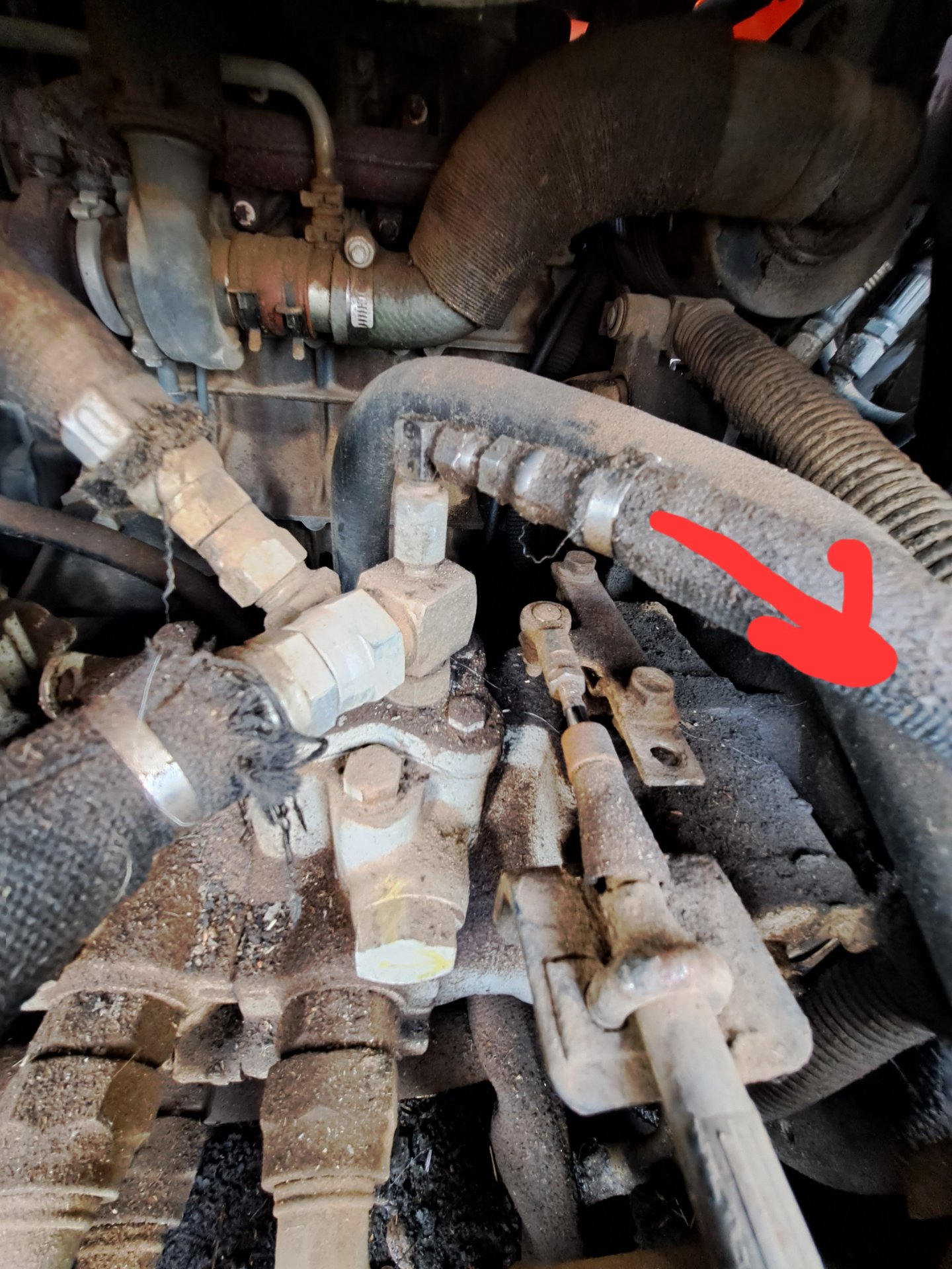

Also, I have a hose leak and I can not find it on my schematic anywhere? It comes off (nipple) the left top of Pump and goes under the left side to a mount with a plug. Some sensor? I will add a picture or two.

I believe that the photo is showing the hydrostatic charge pressure sender and hose.
I included an illustration but I'm not sure it matches your serial number. You are looking at the hose and cover are numbers 20 and 50. The sender is number 23.

Yes, #20 is the hose that is leaking.
