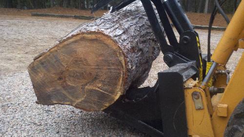

I have that exact one. It works reasonably well, and would probably work for you. I've used it as a stump bucket, and it worked well for an old stump in loose soil. I thought that the grapple may get in the way a little, and it did, but not by much. The cylinder and grapple will come off, but I never saw the need to do so. If I recall correctly, the shipping on this was very fast. I also use it for moving wood. It works for that, too. It's a little hard to get under larger logs- you have to dig under to get enough of the log under the grapple, but it works. You have to engage the log in the middle. The grapple is not enough to cantilever the log very much.

I worried about the exact same thing. Would I just bend the bucket? No problem. It's much "squatter" than the other stump buckets I see on-line. Shorter nose, means less leverage. I don't expect to break it. The 1/2" steel one, is way longer. When I saw it, I didn't like it. The only thing I don't like about mine is the grapple teeth hit closed, a good 6" back from the tips of the 3 front teeth. When trying to pick up a single log...one needs to shove the bucket teeth under it. Often you end up pushing the log forward instead. If I had to do over....I'd buy it again in a flash.
