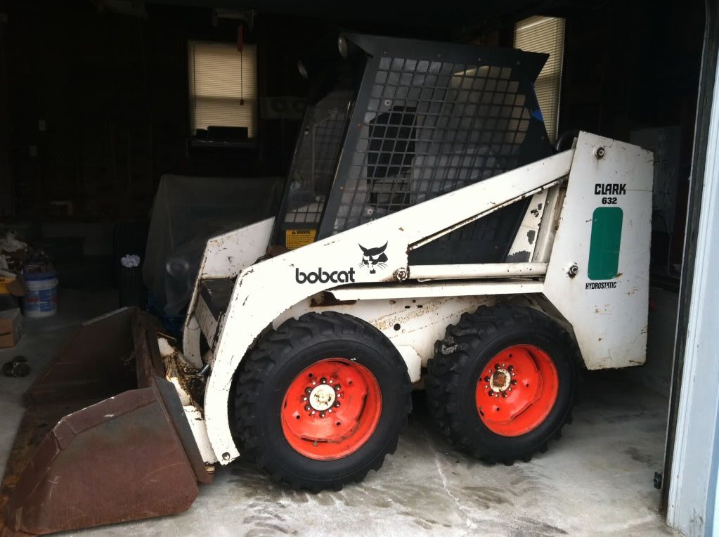

Just picked up a 1979 bobcat 632. 1 owner and has 850 hours and original paint. Newer tires and is mechanically strong. I am currently painting it. I have a few stumps I would like to remove that are about 12" diameter. Would the size of this machine and stump bucket work alright to remove these? There seems to be a few different style buckets and some with serrated edges. Is there a preferred style? Thanks http://i281.photobucket.com/albums/kk221/Tyus4/IMG_0206.jpg
It depends on how high the stump is and what its from. Even the type of soil.
Others have used pallet forks slid together and used it to cut the roots and pop it out of the ground. Essentially what a root bucket does.
I find that if i cut the tree as high as possible so i have some leverage on the stump, it makes it a lot easier. I can poke around the base to loosen it up then grab the stump as high as possible with a 4 in 1 bucket and push and pull at it to get it out.
The machine looks to be in pretty good shape!

When I got my 630 the bar that connects the right control to the aux hydraulics was not connected, not sure if it ever was but all I did was bolt it to the lever and the aux hydraulics worked fine. You should be able to pull the access plate right in front of the seat and tell for sure
I wish mine looked that nice
