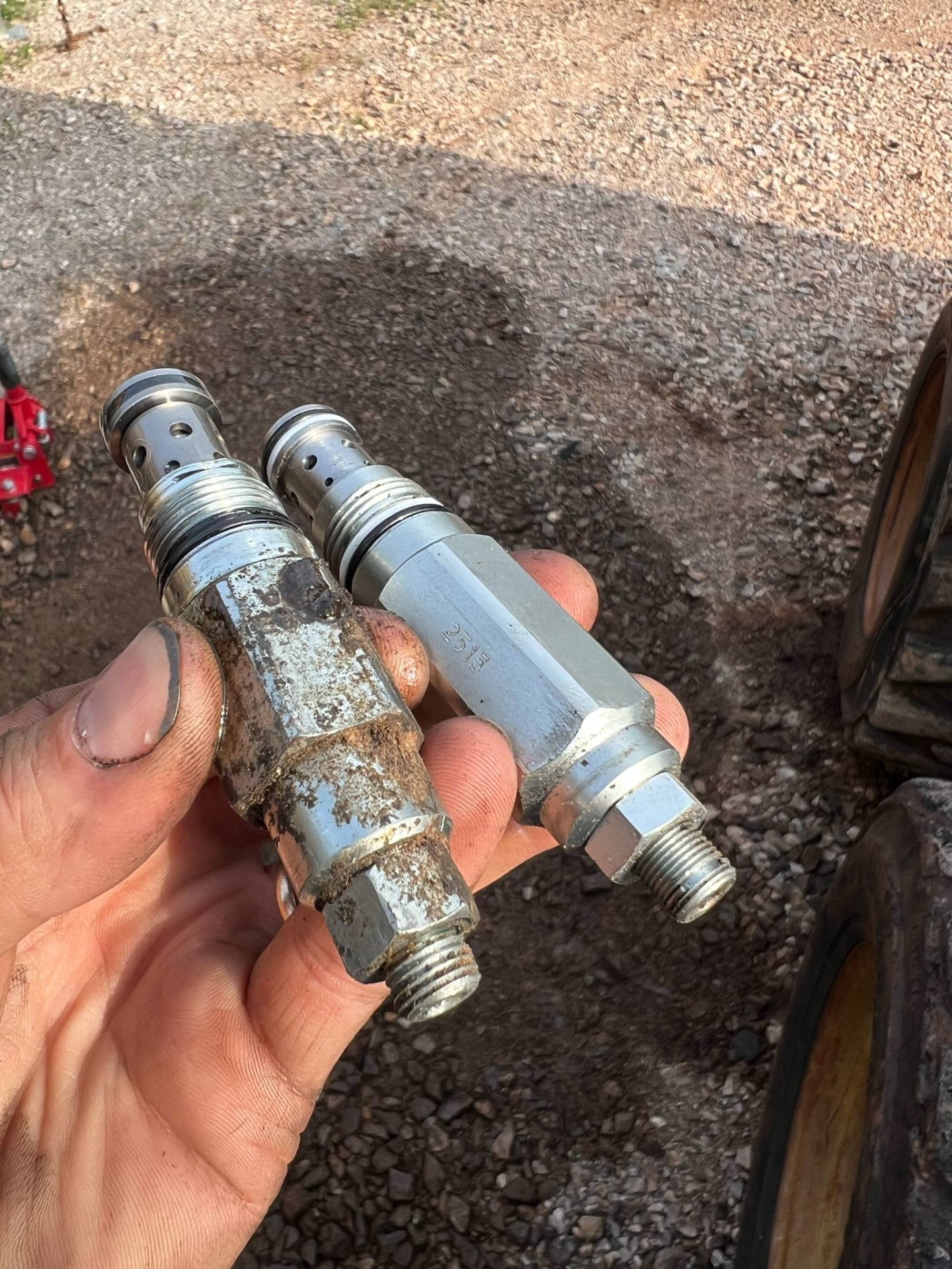

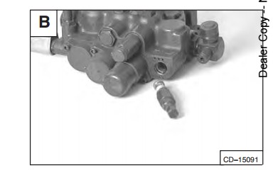

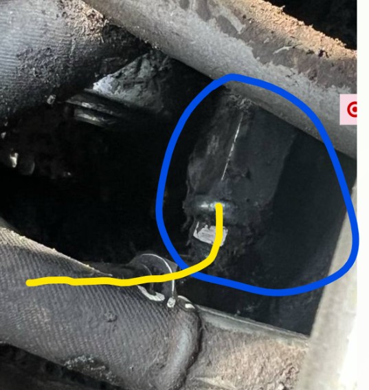

<blockquote data-quote="Climber405" data-source="post: 142965" data-attributes="member: 27703"><p>I have the machine at Bobcat now and the pressure relief I changed is for the Aux Hydraulics. However, this machine has a older style main control valve and the main relief is actually on the front side under the two pins that goto the peddles. Bobcat doesn't have and cant get the main relief to fit the old valve. </p><p></p><p>Finding a main relief valve is now the task at hand but they don't even have a part number.</p></blockquote><p></p>
[QUOTE="Climber405, post: 142965, member: 27703"] I have the machine at Bobcat now and the pressure relief I changed is for the Aux Hydraulics. However, this machine has a older style main control valve and the main relief is actually on the front side under the two pins that goto the peddles. Bobcat doesn't have and cant get the main relief to fit the old valve. Finding a main relief valve is now the task at hand but they don't even have a part number. [/QUOTE]
