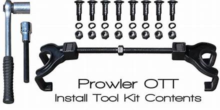

Try this
The fingers are not quite long enough but they are cheap and work well enough.

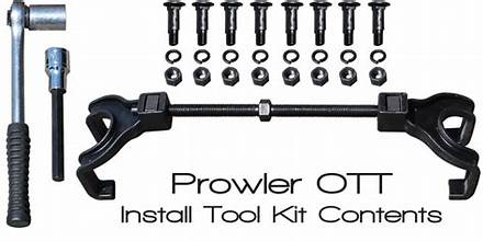

Try this
Have you used these on Grouser track? Finally got my tracks back on with help of several friends a broken racket strap and lots of grunting and sweat. Will order this kit and see if I need to modify the fingers.

I did, on actual Grouser brand tracks, although the fingers need lengthened, they don't go all the way around to lock on. Had to hold it in place until there was enough tension for it to stay. Too make it easier you can jack that side of the skid steer off of the ground. It makes getting the slack out much easier.
Looks like you could weld some extensions on those fingers and then it would work much easier.
