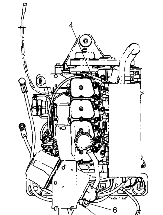

The number 4 is pointing to where the temp sensor is. You can check the wiring from it. Make sure coolant is full. Maybe take sensor out to make sure there is coolant is there and there isn't an air bubble trapped from when you changed it. (Not sure how likely this is, but know it can happen with air to water intercoolers.) That's the first ideas.
I did check the wiring, everything seemed to be tight, looked like it may have had a bit of corrosion so unhooked them and hit them with a wire brush but no luck. I'll try pulling the sensor tomorrow to see if there's any air bubbles. Would you top it off from the sensor if for some reason seems low? Appreciate the help!
