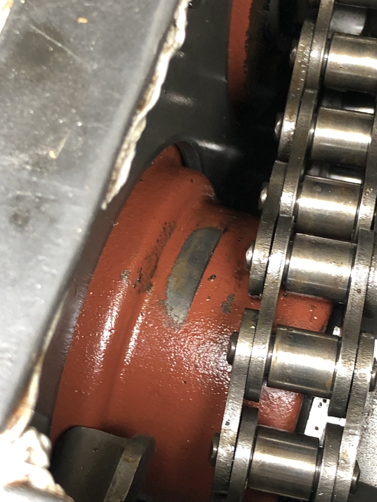

<blockquote data-quote="Samanna" data-source="post: 137252" data-attributes="member: 25481"><p>Hello-</p><p>Would anyone know if you can update the early used steel drive chain guides to the later used plastic chain guides on the Bobcat 743?</p><p>I have a 743 with the small steel ramps and the chains are hitting and machining/grinding away the metal copper colored drive housing just before the guide begins. The later plastic ramps are longer and "hug" the housing in that area preventing the chain from slapping on that housing as shown in attached file.</p><p>I would like to update this 743 to the longer plastic guide ramps if possible and not extreme to accomplish.</p><p>Thanks! in advance to any offering their knowledge or experience.</p></blockquote><p></p>
[QUOTE="Samanna, post: 137252, member: 25481"] Hello- Would anyone know if you can update the early used steel drive chain guides to the later used plastic chain guides on the Bobcat 743? I have a 743 with the small steel ramps and the chains are hitting and machining/grinding away the metal copper colored drive housing just before the guide begins. The later plastic ramps are longer and "hug" the housing in that area preventing the chain from slapping on that housing as shown in attached file. I would like to update this 743 to the longer plastic guide ramps if possible and not extreme to accomplish. Thanks! in advance to any offering their knowledge or experience. [/QUOTE]
