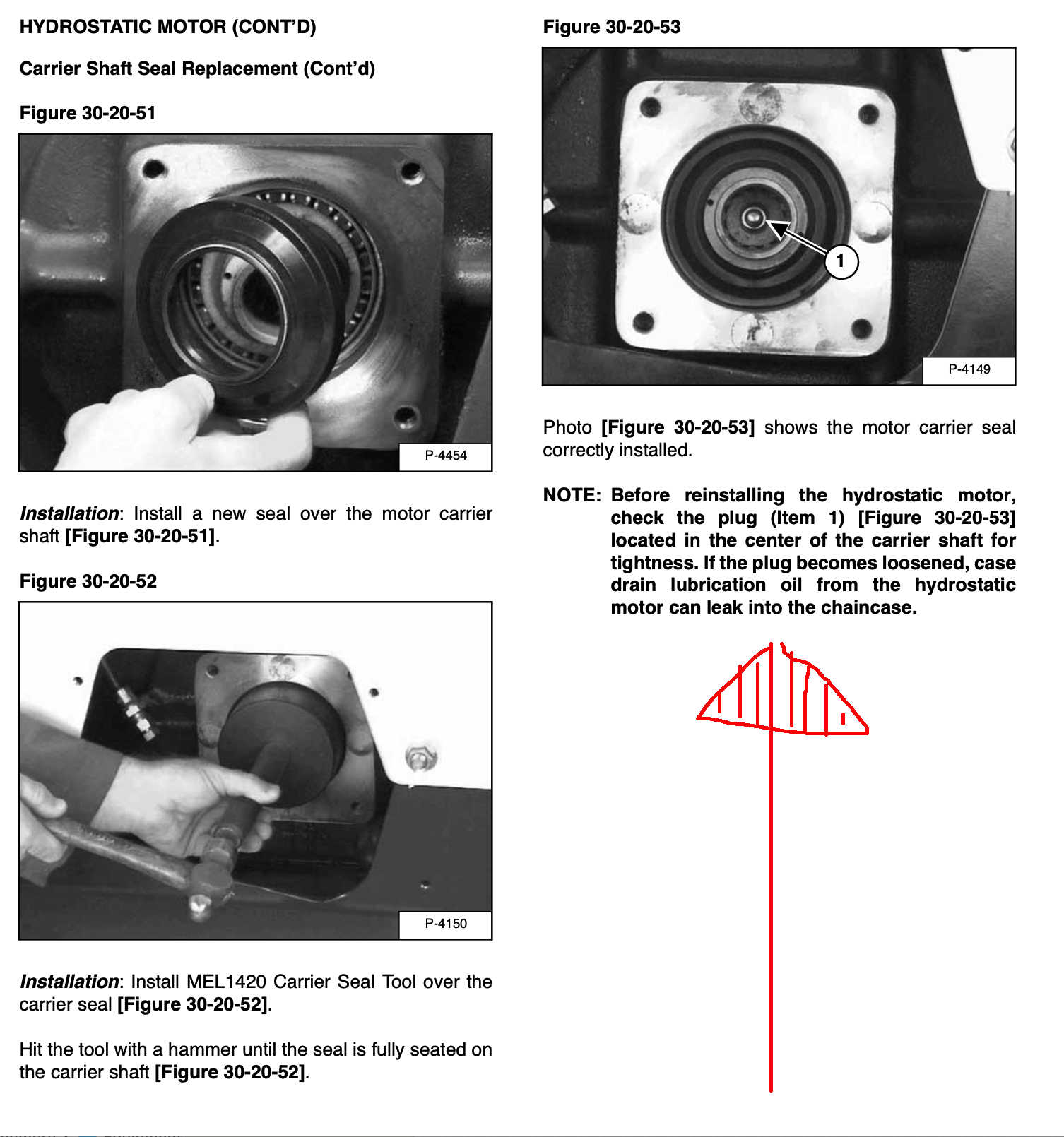

<blockquote data-quote="anthonyobrienjhb" data-source="post: 140626" data-attributes="member: 26399"><p>I know that this is an old thread, but this seems to come up regularly. </p><p></p><p>I found this under Carrier Shaft Seal Replacement in the service manual for the 773: </p><p></p><p>"</p><p>Note: before reinstalling the hydrostatic motor, check the plug located in the centre of the carrier shaft for tightness. If the plug becomes loosened, case drain lubrication oil from the hydrostatic motor can leak into the chaincase.</p><p>"</p><p></p><p>No guarantees, but worth checking if chaincase is filling with oil.</p><p></p><p>Image attached...</p></blockquote><p></p>
[QUOTE="anthonyobrienjhb, post: 140626, member: 26399"] I know that this is an old thread, but this seems to come up regularly. I found this under Carrier Shaft Seal Replacement in the service manual for the 773: " Note: before reinstalling the hydrostatic motor, check the plug located in the centre of the carrier shaft for tightness. If the plug becomes loosened, case drain lubrication oil from the hydrostatic motor can leak into the chaincase. " No guarantees, but worth checking if chaincase is filling with oil. Image attached... [/QUOTE]
