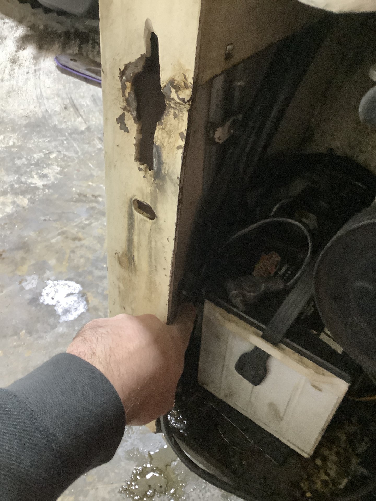

<blockquote data-quote="spitzair" data-source="post: 122942" data-attributes="member: 3333"><p>Sounds to me like someone crossed the hoses on the lift cylinder on one side. I once rebuilt a lift cylinder and got the hoses backwards on one side and it did exactly what you are describing. If it seems like the right side is lifting but the left side isn't I would suspect the left side to be the problem. Try switching the lift cylinder hoses for the left lift cylinder and see what happens. They are easiest to switch in the engine room down on the left side near the floor. The picture is of a 732 but they're in the exact same place on your 743.</p></blockquote><p></p>
[QUOTE="spitzair, post: 122942, member: 3333"] Sounds to me like someone crossed the hoses on the lift cylinder on one side. I once rebuilt a lift cylinder and got the hoses backwards on one side and it did exactly what you are describing. If it seems like the right side is lifting but the left side isn’t I would suspect the left side to be the problem. Try switching the lift cylinder hoses for the left lift cylinder and see what happens. They are easiest to switch in the engine room down on the left side near the floor. The picture is of a 732 but they’re in the exact same place on your 743. [/QUOTE]
