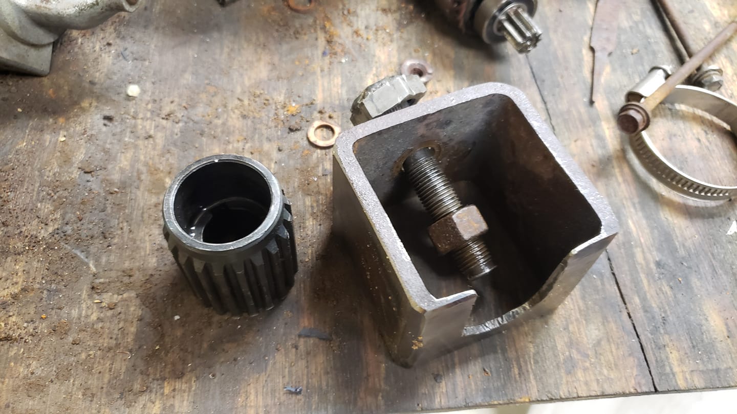

<blockquote data-quote="flyerdan" data-source="post: 114900" data-attributes="member: 2510"><p>Rather than risk messing up the internal shaft in the pump, I'd be inclined to modify the splined adapter to accept half of the lovejoy coupler and put it back. </p><p>Good job on the custom puller, if you'd known that it was a taper shaft you could have hit it with an air hammer and dull chisel when it was under tension and it would have popped right off.</p></blockquote><p></p>
[QUOTE="flyerdan, post: 114900, member: 2510"] Rather than risk messing up the internal shaft in the pump, I'd be inclined to modify the splined adapter to accept half of the lovejoy coupler and put it back. Good job on the custom puller, if you'd known that it was a taper shaft you could have hit it with an air hammer and dull chisel when it was under tension and it would have popped right off. [/QUOTE]
