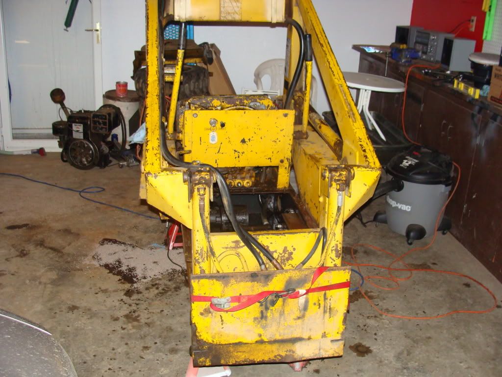

So the dissassembly began. I know that I probably had bearings out in the axle tubes and that the engine was shot. So first I dissassembled the loader.
Front Disassembled

After that the only thing to do was remove the engine. Same thing. No bolt was welded on the backside but after some more time wrestling with it the engine came out. I purchased the correct bearings, cups, and seals and the axle tube are currently at our local machine shop getting pressed in for me. I will be getting the skidsteer cleaned up with my pressure washer and clean out the engine bay. As far as I can tell there is an empty area beneath the engine compartment that is simply full of junk. Once I get that cleaned out I will be adding a 100 lbs of counterweight and filling to rest with foam with a cover so it doesn't fill with oil and dirt again.
I will keep you updated on the progress
rear without engine Right side disassembled
