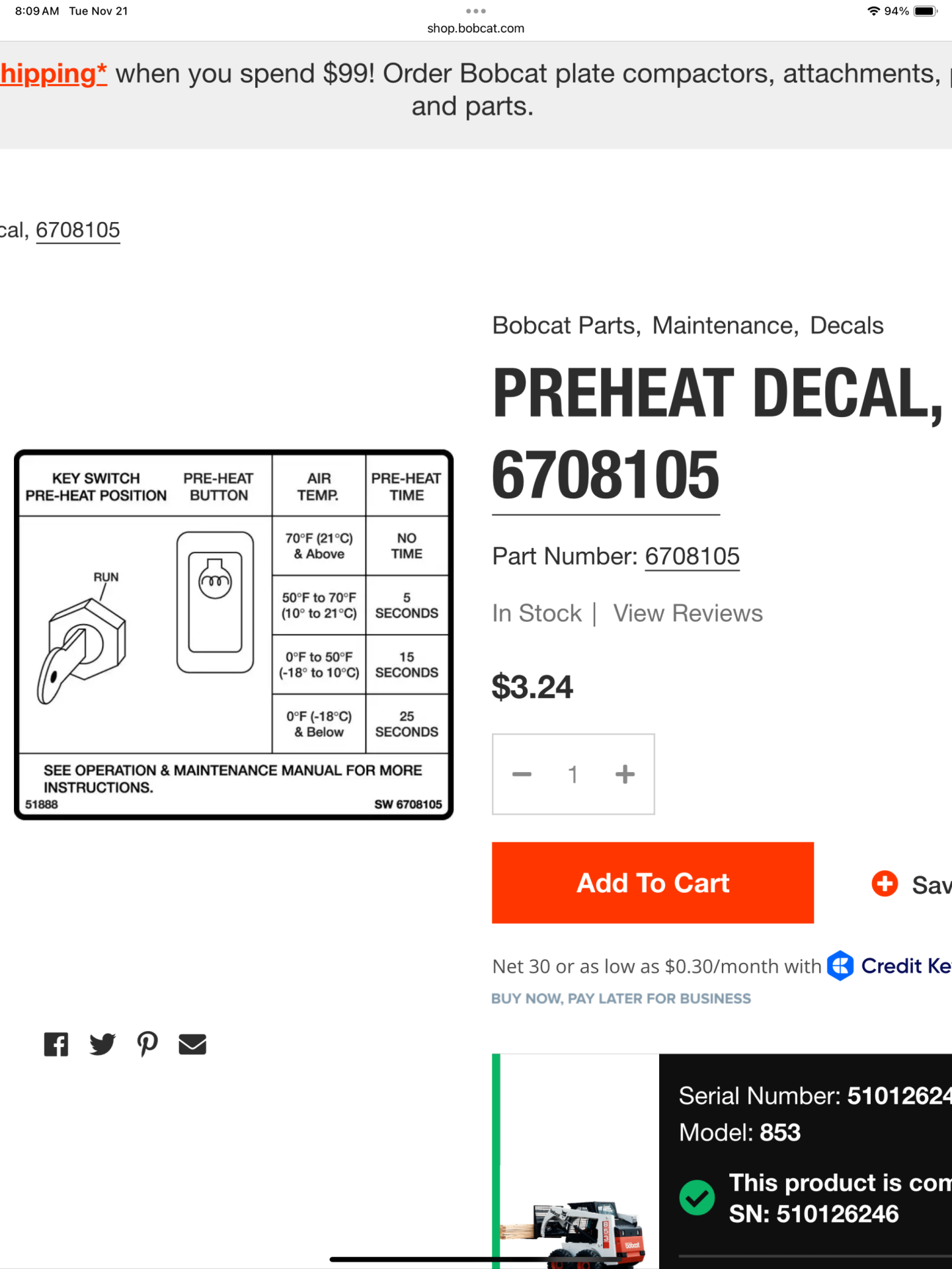

wateka
May 25, 2022
126
FWIW, the 853's have an Isuzu diesel and came with a sticker showing preheat time based on the air temperature.
