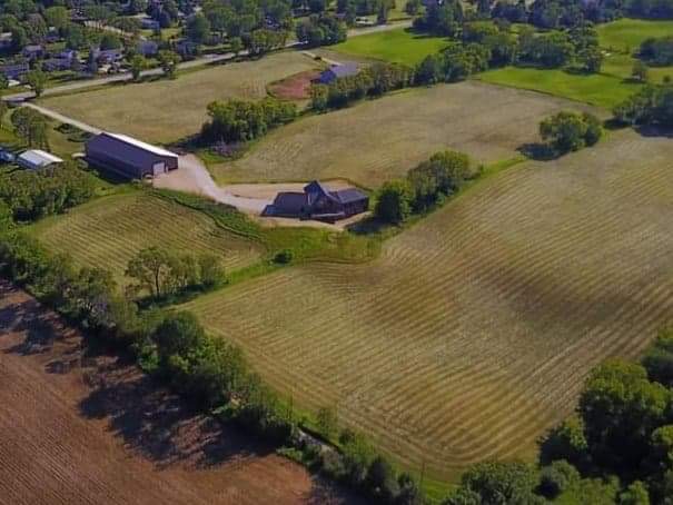

The only reason I would prefer digging vs grinding is I am trying to convert the couple of tree lines I have back into field. I have 13 acres of alfalfa that I rent to a local farmer and it would be easier to bale without have to go around the trees. The attached pics shows the trees.

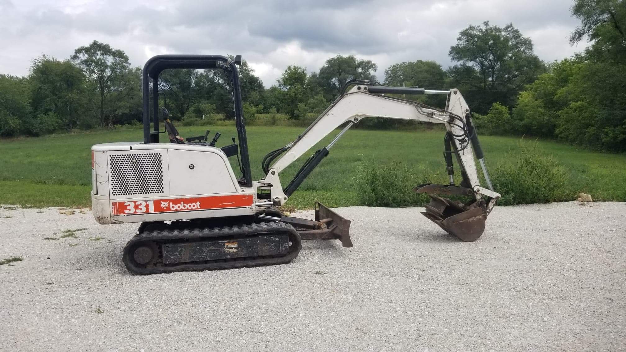

Thanks everyone for your helpful advice. I pulled the trigger today and picked up this Bobcat 331. It checked all the boxes on my wishlist with one exception (it doesn't have a close cab) but that's OK because I just ordered my bee suit today. Played with it a little bit and I will say it takes a little getting use to. Unlike a skidsteer there's more moving parts but I look forward to getting familiar with all of them.
I will say I was just about ready to give up the search for a mini and go after another backhoe but then this one hit the market at the last minute, was close and the seller delivered it to my property.
A backhoe could have done the same job but I look forward learning how to use a new toy.

well congrats to you and best of luck with the new addition of tools to play with,
and I think you will find, an excavator is a much more useful tool than a backhoe is, once you get some seat time in!
