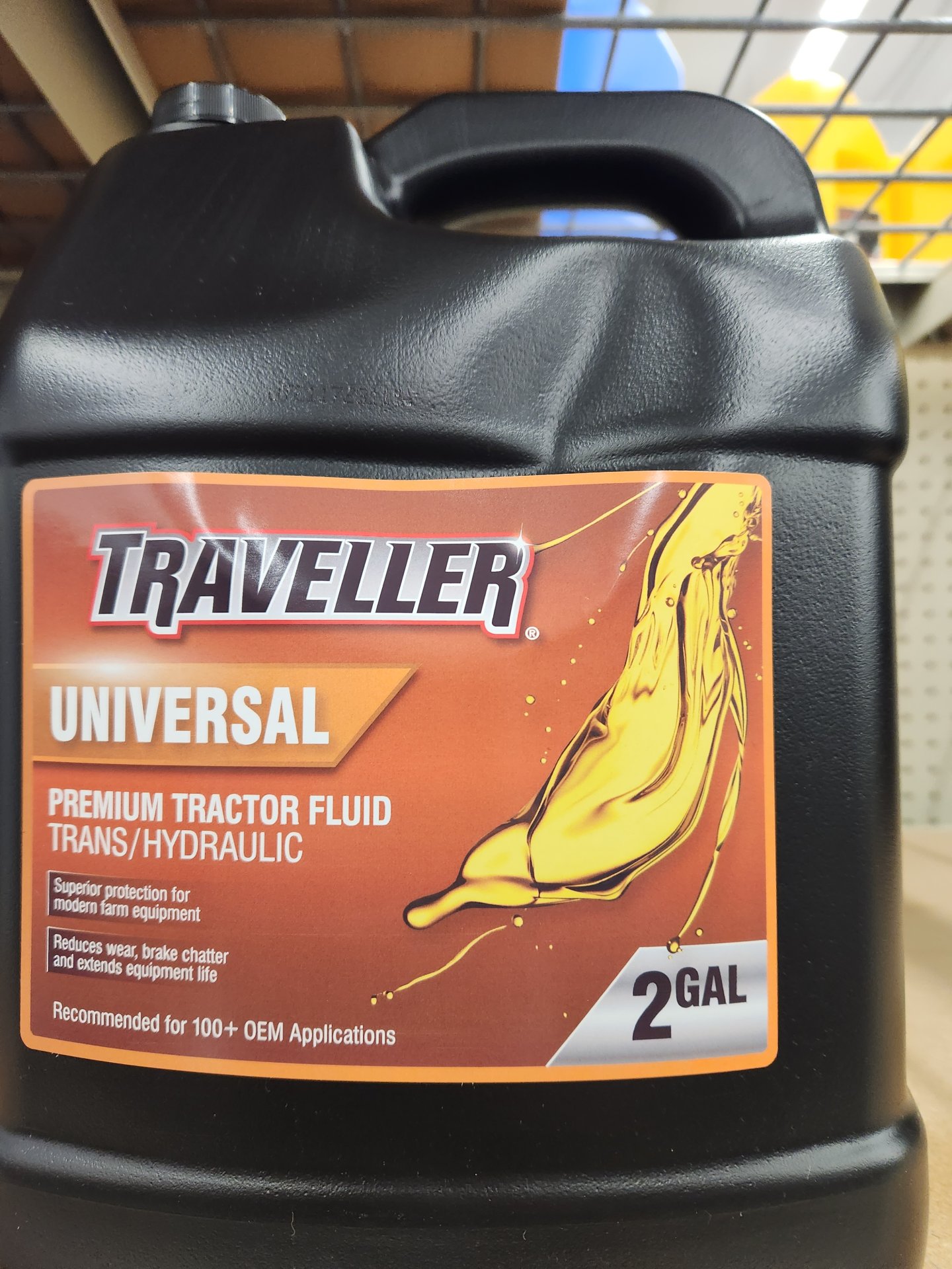

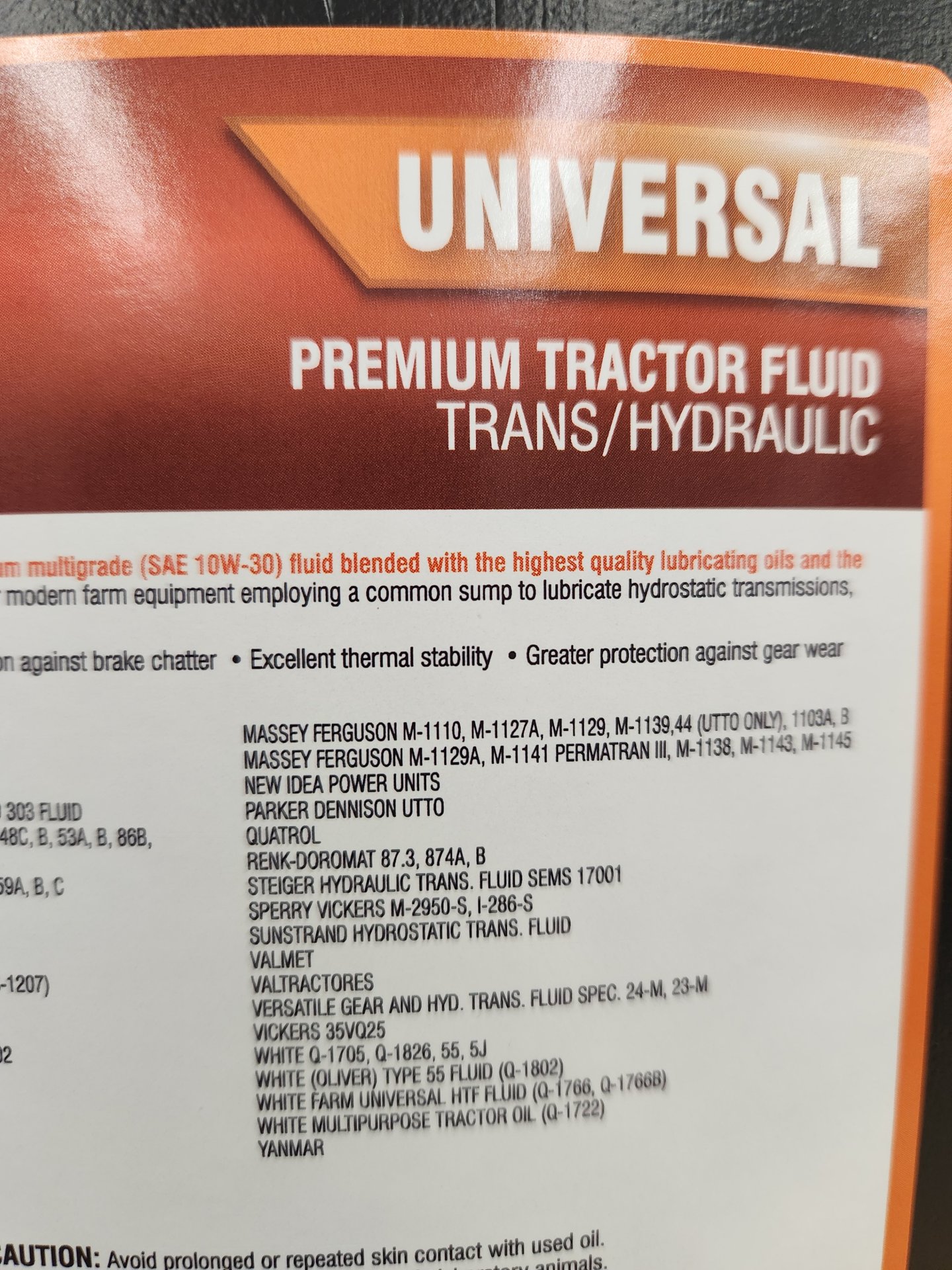

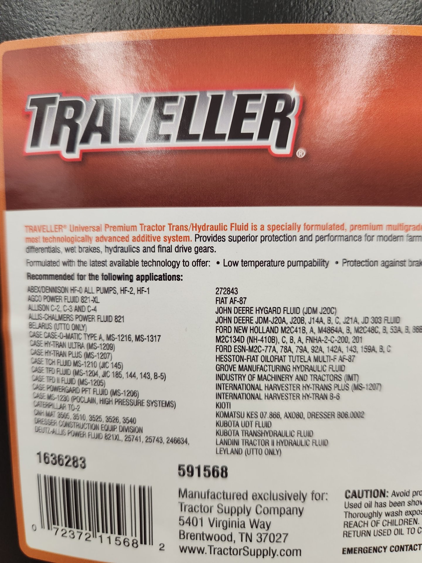

Something like this?

aw-46 is used on many systems, it is 15 weight hydro oil which is a good weight for average temp. climates.
I don't see anything about it that I don't like.
Regarding the AW hydraulic fluids, they typically have antiwear additive (such as ZDDP) concentrations in the mid hundreds PPM range, say 400-600 PPM, where the premium hydraulic oils with have antiwear additive levels in the 1000+ PPM. In a gear pump system I would be OK with an AW oil, but not in an axial piston pumps system which is what skid steer hydros are. Most of the drive motors are axial piston also, but the 1835B is an exception to that. Premium hydraulic oil is cheap compared to a failed axial piston pump. Been there, done that.

Yes, regarding hydraulic oils. Pump manufacturers have specifications for the oils recommended in their systems, and they trump the machine manufacturers. Those specs should be on the container or available. Here are a few.
Vickers - 1-286-S, M-2950-S.
Cincinnatti Machine - P-68, P-70, P-69.
Dennison - HF-0/TSC, HF-0/T5D
Must meet ASTM D943 and have an AGMA rating of at least grade 1.
Yes, if they meet pump manufacturers specs. Read the fine print, not the glossy label.
