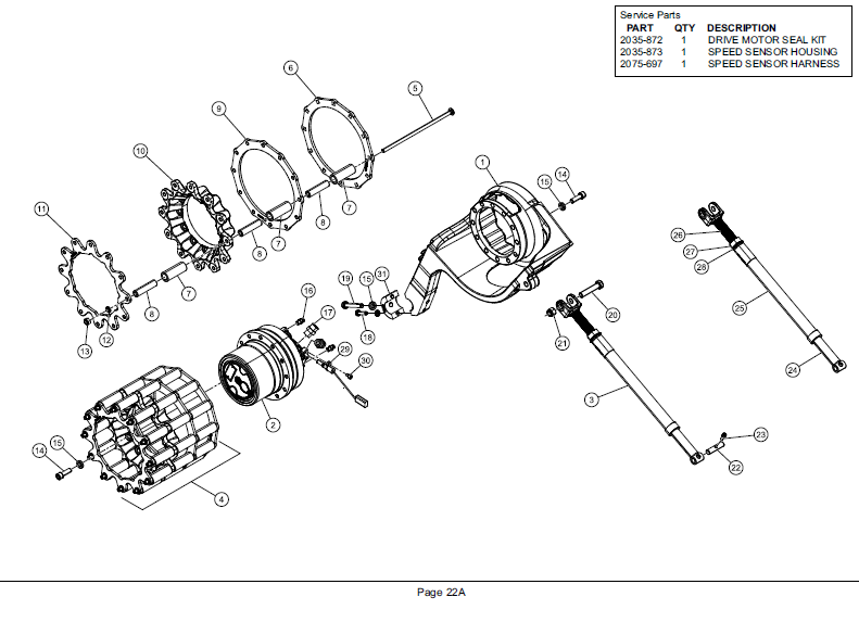

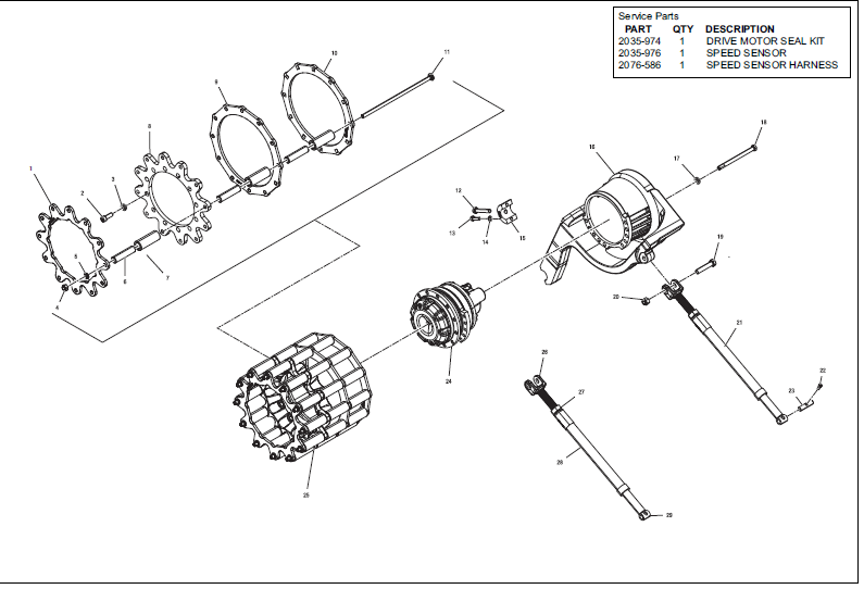

Do you have any codes coming up? Like one that says "Undesired track movement"... If that code has not shown up then you most likely have a drive motor that is failing. Now if that code has come up then you can take a look at the speed sensor or speed sensor harness possibly being the problem. Though I'm thinking not likely unfortunately.
Depending on serial number is going to depend on which one of the below is yours. Just need to get ahold of your local dealer and they should be able to help you figure this out.
