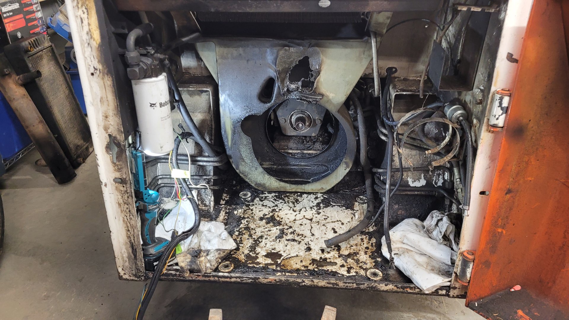

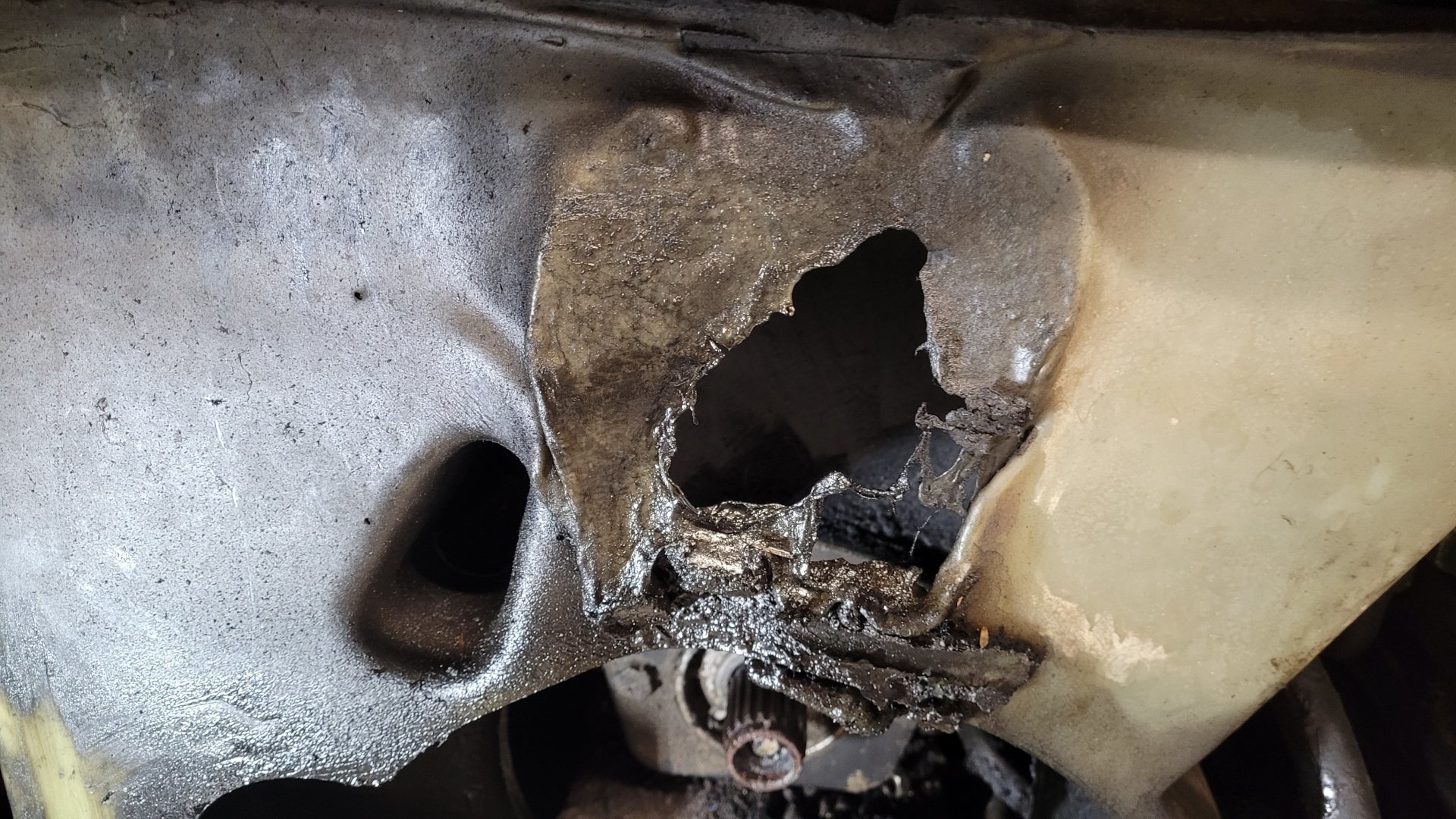

I pulled the engine out of my 742B for overhaul, and the squirrel fan shroud is umm, not so great.
I'm thinking I'll patch it with some aluminum sheet and screws/nuts, if that seems reasonable?
Also, I'm assuming there was supposed to be a cover over the big rectangular opening above there? It was just open.
The machine obviously was overheated at some point. I'm struggling with the idea of overheating it enough to melt that shroud, but I guess so. There was no thermostat in it, and the radiator has some repairs on it.

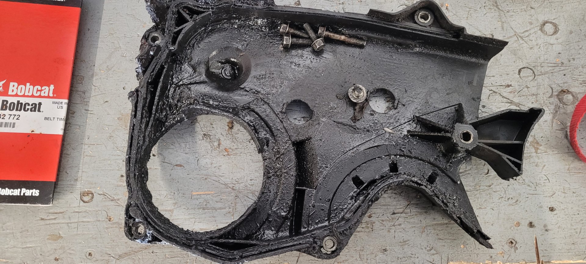

Also the upper timing belt cover was just missing, and the lower one is all deformed, I'm guessing the heat also got it. Other than losing the ignition timing marks, which I think I can work around with a dialback timing light (I have a fancy one for setting up propane), is there any reason I can't just ditch them? They're NLA from Bobcat and I don't think I'll have much luck finding them used.
You can see where the belt was rubbing it even. Plus the head of a broken bolt, but that's another story.

Has anyone ditched the whole squirrel fan setup and just put a couple electric fans in on the radiator/hydro cooler? I can throw the fan on my lathe and remove the blades and balance it, but that's the sort of mod there's no going back from.

Yes, there is a thick sheet metal piece that sits at a slant covering the opening above the fan shroud to assure that all the air must go through the Hyd oil cooler and/or the radiator. Should be pretty easy to fabricate. (FYI, Mine was a little tight to get in and out with the radiator hoses in place, but doable).
And, if it were me, like you I would also plan on sheet metal patches to more or less duplicate the shroud where damaged. There are still some 4g32 engines in wrecking yards. I'd try to get the timing covers via that route. Some 4g32s had a timing chain, others a belt. The chain version won't have similar covers. And some had dual cams. They may not work either, not sure. Don't know about the silent shafts version. Look for ~ 77-80 Dodge Colt or similar car. It will probably have to be a rear wheel drive version.
I don't know if the Colt has the same timing cover or not. It does not have the same timing belt and pulleys. It may have counterbalance shafts too, which would probably make everything different. I have a gasket kit from one that I was going to see if it is the same on the cover, if it is then the covers are probably the same or close enough. Assuming it is the same, were still looking at finding a part for a 40 year old car that wasn't very popular, not to say it can't be done.
The other piece I realized is missing, or so I assume, is a divider between the radiator and muffler. Simple to make, but annoying that somebody would be so lazy as to not put it back in.
