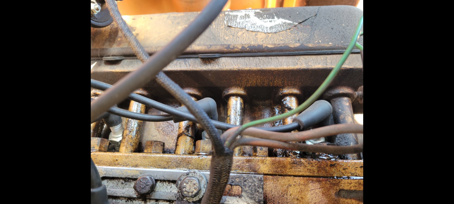

Like i mentioned when it runs it runs great, moves great, lifts strong and quick, doesn't act rich or lean or starving for fuel. Doesn't really sound like there is intermittent spark or sputtering, sounds pretty smooth as far as I can tell. Just shuts off. Anyway just thought I'd see if anyone here had some thoughts they could share. Has some minor hydraulic leaking from bucket cylinders and what seems to be oil leaking from the outer valve guide tubes on the cylinder head. Otherwise it seems like a clean machine.
