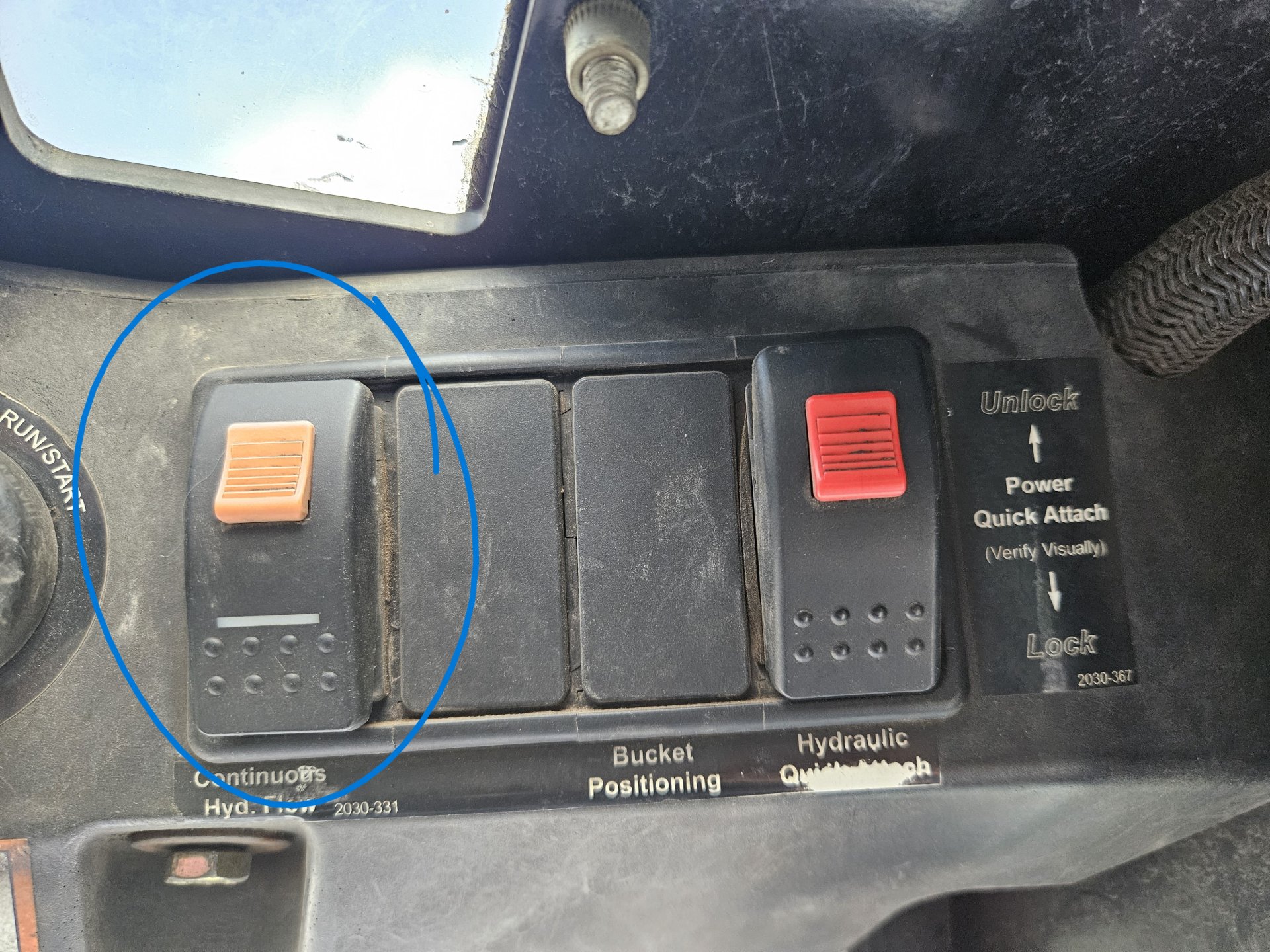

- the overhead switch (pic) works as-in if the switch is ON the machine won't start. So, it knows when the switch is engaged... The switch on the right for the quick attach works fine to lock/unlock attachments.

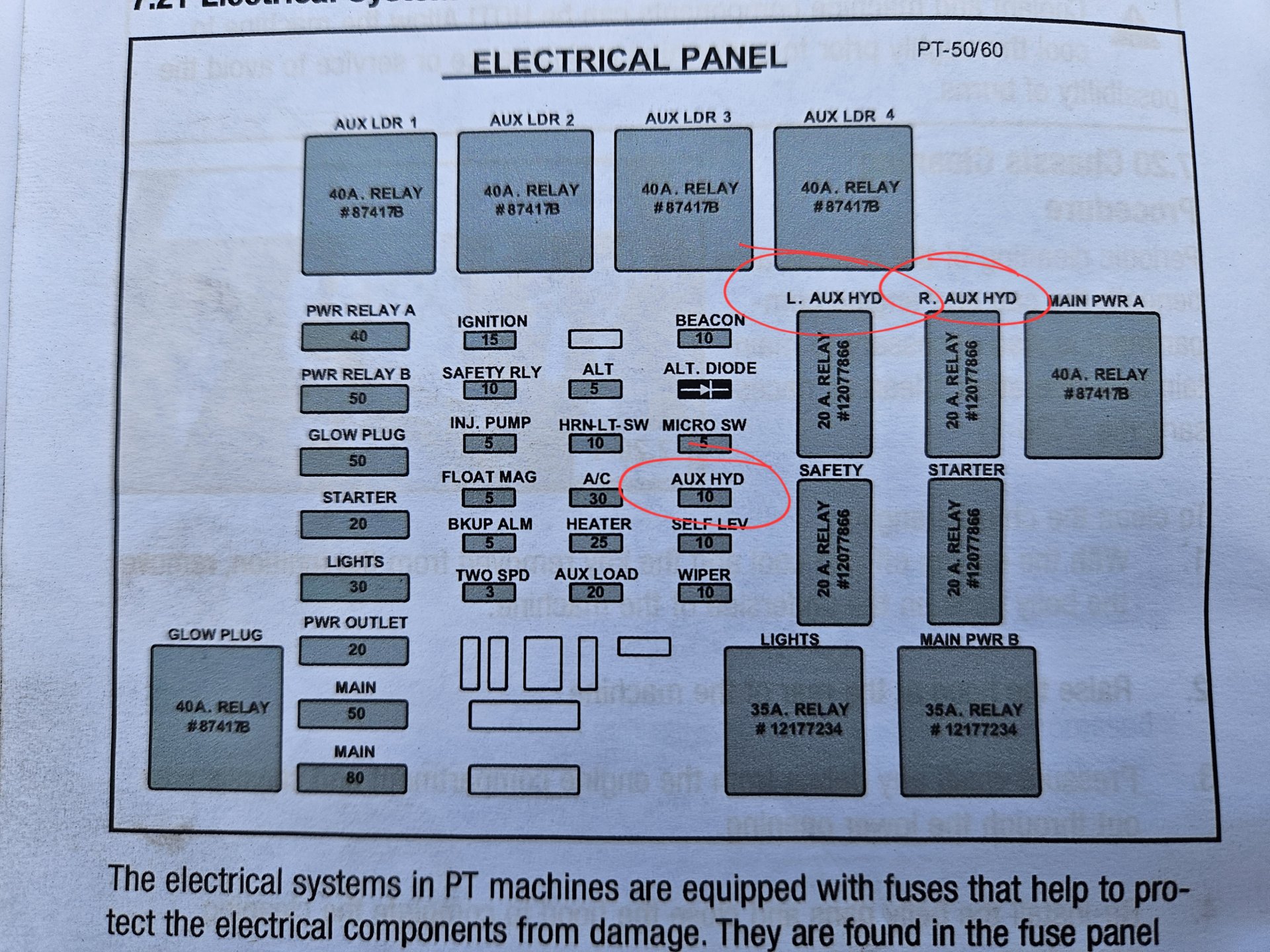

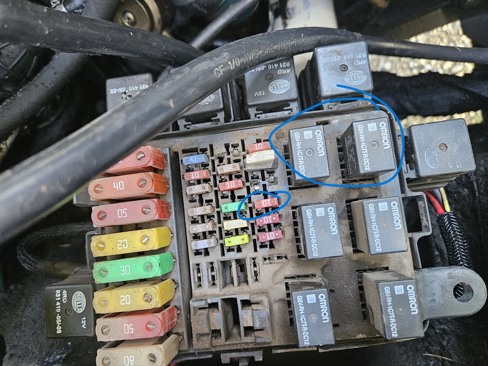

- the fuses are good, except for one for "micro sw" (Pic) I need to find this short. Is this mirco SW fuse a part of the problem?
- checked the relays ohms and they are OK (78ohms +/-).
- The right joystick works to run the bucket and lift etc. The horn button works. The other thumb button (wide one) is supposed to be the intermittent Aux Hydraulic button. When I press this, nothing happens.
