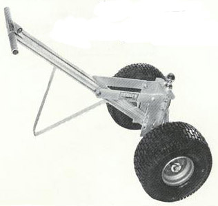

Welcome to the Bobcat Forum. My brother-in-law welded a reciever hitch to the back of his 873 to pull a trailer. It hangs down below where the door opens. If it drags through the ground on inclines, just clean out the dirt before inserting a reciever and ball. Personally, I was thinking of making a dolly with a trailer ball mounted to the top (example picture:http://www.ahoycaptain.com/shop/media/Trailex HD Trailer Dolly.JPG). I haven't decided to make a dedicated Bobtach for the dolly, or fork pockets. I have also seen and pintle hook with a hydraulically operated latch on the front of a Bobcat for moving many different trailers.

Welcome to the Bobcat Forum. My brother-in-law welded a reciever hitch to the back of his 873 to pull a trailer. It hangs down below where the door opens. If it drags through the ground on inclines, just clean out the dirt before inserting a reciever and ball. Personally, I was thinking of making a dolly with a trailer ball mounted to the top (example picture:http://www.ahoycaptain.com/shop/media/Trailex%20HD%20Trailer%20Dolly.JPG). I haven't decided to make a dedicated Bobtach for the dolly, or fork pockets. I have also seen and pintle hook with a hydraulically operated latch on the front of a Bobcat for moving many different trailers.
