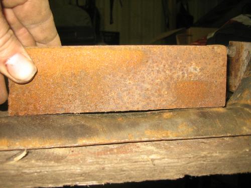

As for any track being re buildable for ever though I should post some pics of my old Loegerings. It shows the significant amount of wear tracks get from the tire side. There is always sand and grit between the tire and the track and over the life of the track it takes it toll from the tire slipping on the inside too.
I welded up those tracks with mig wire on the inside and hard surfacing on the outside. But the pivot pins were a rivot in so there was no easy repair there. I sold that machine and tracks a year later and to my knowledge they are still seeing limited service at a fellows cabin. However it was alot of work to build both sides up and dress the inside down so it was not too hard on the tires. Also they could only be shortend 4 more inches and that was it. I felt the pivots were 1/2 used at the time I rebuilt them and the pads were a couple hundred hours from breaking down the center
For the time and money I put into them to prevent the pad from breaking down the center, I know it would have been more cost effective to replace them with new. Considering what new ones can be had for now.
One final point. I don't believe the difference in traction between one brand and another is near as large as the mfg's videos would like you to think. If you have never run tracks, any track will make a huge improvement in traction/pushing power on soft or loose soils. The heavier the track, the more you will sink into soft ground and the more stabil your machine will feel with a heavy load.
Ken
Here is a picture of the tire side (inside) of the loegering track pad.

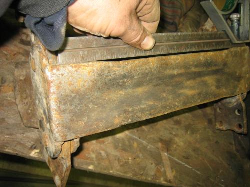

Here is a picture of the leading edge, these 2 places and the pivots are where most of the wear takes place
Tracks plus pad with Loegeuring
