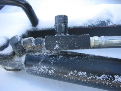

As for orifices I used 2 $20.00 1/8” pipe size, hyd flow restricter valves from www.surpluscenter.com If you don't angle your plow more then once a minute, the oil will cool enough in the hoses (use something small, 1/4” say) to keep things under control.
But go back and forth a couple times and the only way to get the plow to stop where you want is to idle the engine.
I'd say about a 1/8” orifice would work, in the colder months I open my valves fully, but if it gets to + 10 f then I chokeing the flow back down.

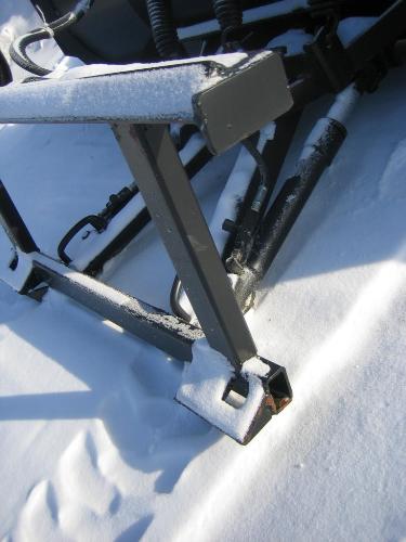

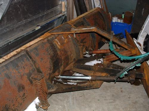

More pics and info in Snow Plow Meyers pickup conversion to skidsteer folder, under media
Adjustable restrictor
Push frame 3/16 wall 1 1/2“ by 3“ box
Top and lower QA hooks are 3/8“ flat bar
Tripple trip springs
Pivot that I broke on Rh side of pic.
Failed at weld from boss to angle iron

I posted a picture showing the brace on the top of the plow I used a soild backing plate and tried to keep the push arms realtivly straight .Jeff http://www.skidsteerforum.com/DesktopDefault.aspx?tabid=52&gallerypage=1&currentitem=3&path=Community%20Image%20Storage
