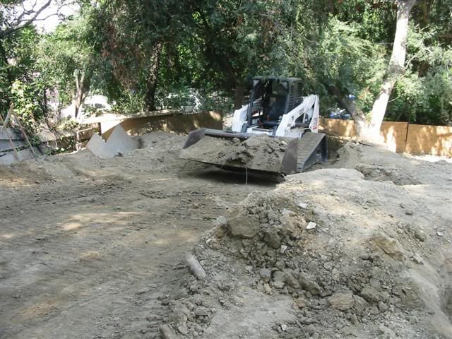

Today went pretty well. I measured the slope and it is not a 1 to 1 as I had feared. Its a little less than 1 to 1 but I forgot exactly what I had measured. I will make sure I remember tomorrow.
I cut grade going down hill first with the tooth bucket. I was only able to get half scoops.Then I backed up the hill and loaded the dirt into my 10 wheeler. I then wanted to try and grade by cutting upward. I drove down the slope backward with a bucket full of dirt just to make sure I wouldnt just flip backward if I had an empty bucket. Everything felt okay untill I began dumping out some of the dirt in the bucket. It began to feel a little light in the front and that worried me. So I decided to put my 963's smooth bucket on and use it to grade. The smooth bucket has about a 1.3 cubic yard capacity. So as I graded up hill, I would leave about 1/4 to 1/3 of the bucket full of dirt to act as a counter weight for the front end. This worked realy well. If you where to do this with the tooth bucket, the amount of counter weight dirt that I felt comfortable with would not leave you much room for spoils.
That first attempt at seeing if I could grade uphill on that slope was kinda scary. Remember, Im accessing this job from the top of the hill and theres no place to turn around at the bottom of the slope. Its not like Im at the bottom of the hill and climbing upward and then seeing what the machine can do and if it gets kinda scary then I could simply go back down.
Below are some photos from the today.
View from above.
Street down below.
View from side.
View from below.
View from other side.
If you want to see all the photos just click on a photo and it will take you to the photobucket gallery.

EER i wouldn't even attempt a job like that, that slope would scare the hell out of me! Just looking at the pictures i can imagine my machine rolling onto its back.
The angle looks insane, but its doing a really good job of it.
No power problems with cutting up such a steep grade? I take it your having no problems with it bogging down?
Well done!

I have found there are no problems with the engine power or proper oiling etc when on slopes that steep. However, I have found that you must have the hydraulic tank full to prevent air in the lines.

Also, I always use my 4in1 bucket on really steep slopes. They are a lot heavier than the normal buckets (I have a John Deere 78" 4n1 that I modified - holds a yard of material and weighs 1250lbs empty). The extra weight and the fact that you can dump dirt without raising the bucket really make them the ticket for steep hills. I turned down a job like yours one time because at the bottom was a sheer drop of about 75 to 100 feet and there was nothing to prevent you from going off of it if something went wrong. I just didn't want to take the chance. I gave it to a friend that has a D4 and is really nuts on hills with it. I really like to watch the guy work because of some of the insane things he does. It is like he spends a lot of his time on the ragged edge of its capabilities. He has a reputation for his hill work.

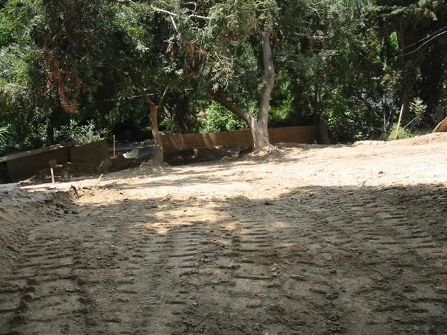

Well I measured the slope and its about 33 degrees or 12 inch run to a 8/9 inch rise. The job was a little challenging and fun. I hauled out about 50 cu. yards of dirt in two days and I was realy taking my time on this. I was not in a hurry at all. I left about 15 yards at the bottom of the hill because the contractor said that its good enough for now. He still has to redrill 3 caissons and dig grade beams to connect all the caissons. The reason he has to redrill some holes is because the 3 holes on the side are to close to the property line.

Here are some photos from the second day.

You have done well, i wouldn't have the guts to even attempt that job.
I know how stable my machine is on my driveway which isn't close to that grade, its awfully light on its feet. Mind you, its not a track loader, that would help things a bit too.

Nice work. Is the T250 rented?
