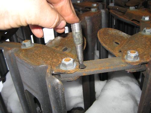

I use a 5/8 bolt with the head cut off, threaded end machined to a taper to align the pin holes when joining the track. Use the taper to pull the holes in alignment, then clamp the pads down on the strap with a vise grip. Then you can take out the tapered bolt and put the proper pin in without the track pulling apart.

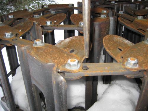

I pull the ends up with 2 ratchet straps, get the ends up on top and between the tires then put the ratchet hooks one on top of the fron tire and one on top of the rear tire and run the strap below the track so it hold each ends up for you.
Pull them snug, then once I get the ends together so I can see any hole I pull them with a tapered punch like this

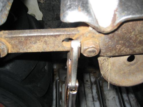

and the hold them with vise grips like this
