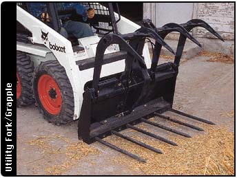

I have a 66” Bobcat manure grapple that I have used alot for brush mid sized tree and smaller loose boulders up to 20” or so. It has straight tines on the bottom space every 6 or7” and i added extra tines between each one on the bottom in the empty holes to narrow it down to 3.5
Its alot like this on except it has bolt in tines on the top as well as the bottom. Room for up to 8 on the top and 15 on the bottom
The tines are vary springy and I have never broke one. It just has one cylinder and a single grapple on top and 4 curved tines across the front of the grapple.
It is fairly light yet well made. works well for brush and pulling willow roots from the soil, as well as back dragging. I would have bought the 60” but my plan was to upgrade to a 773. However the 66” worked well on my 753 and it could be narrowed by removing some of the outside tine.
