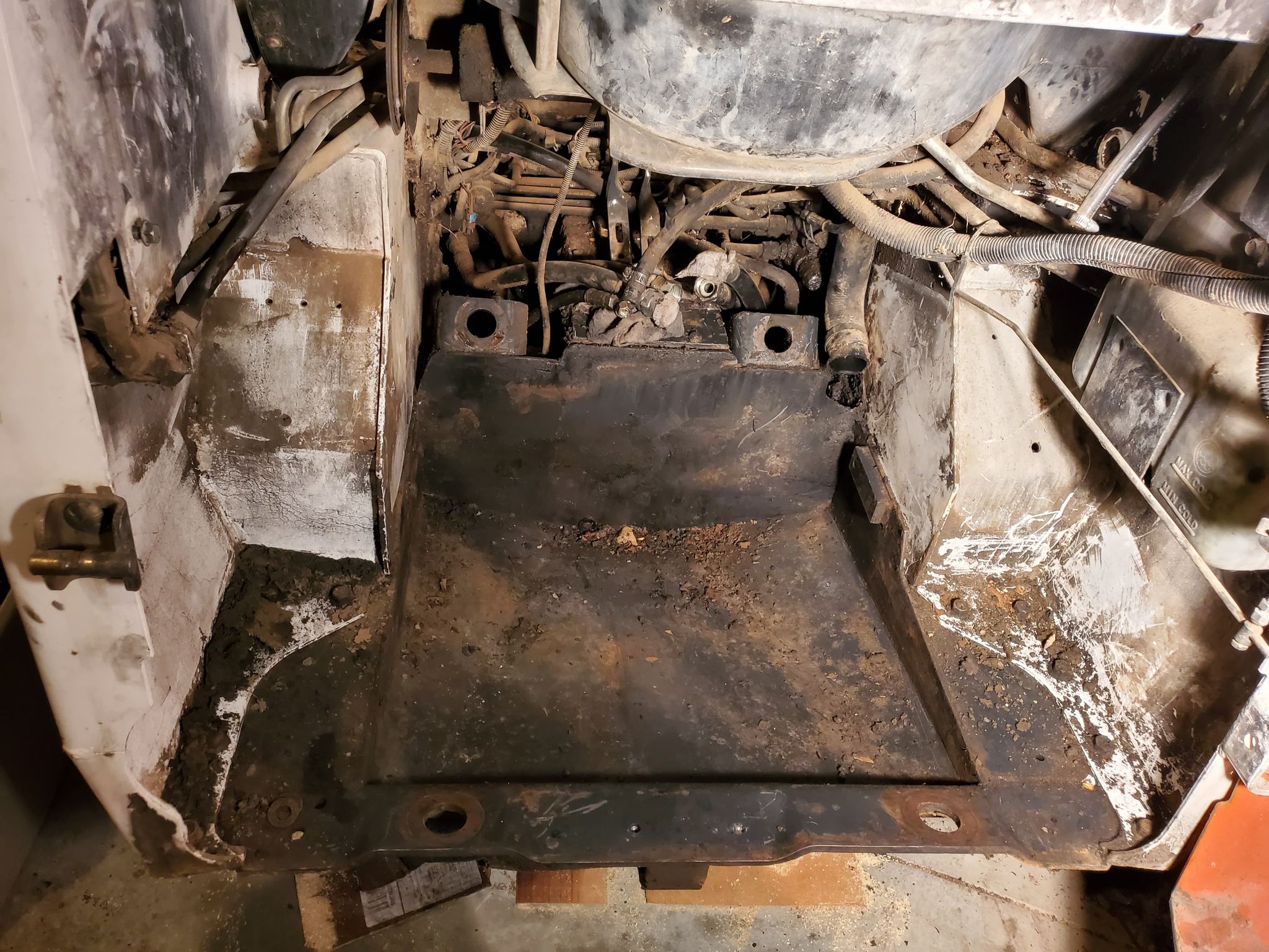

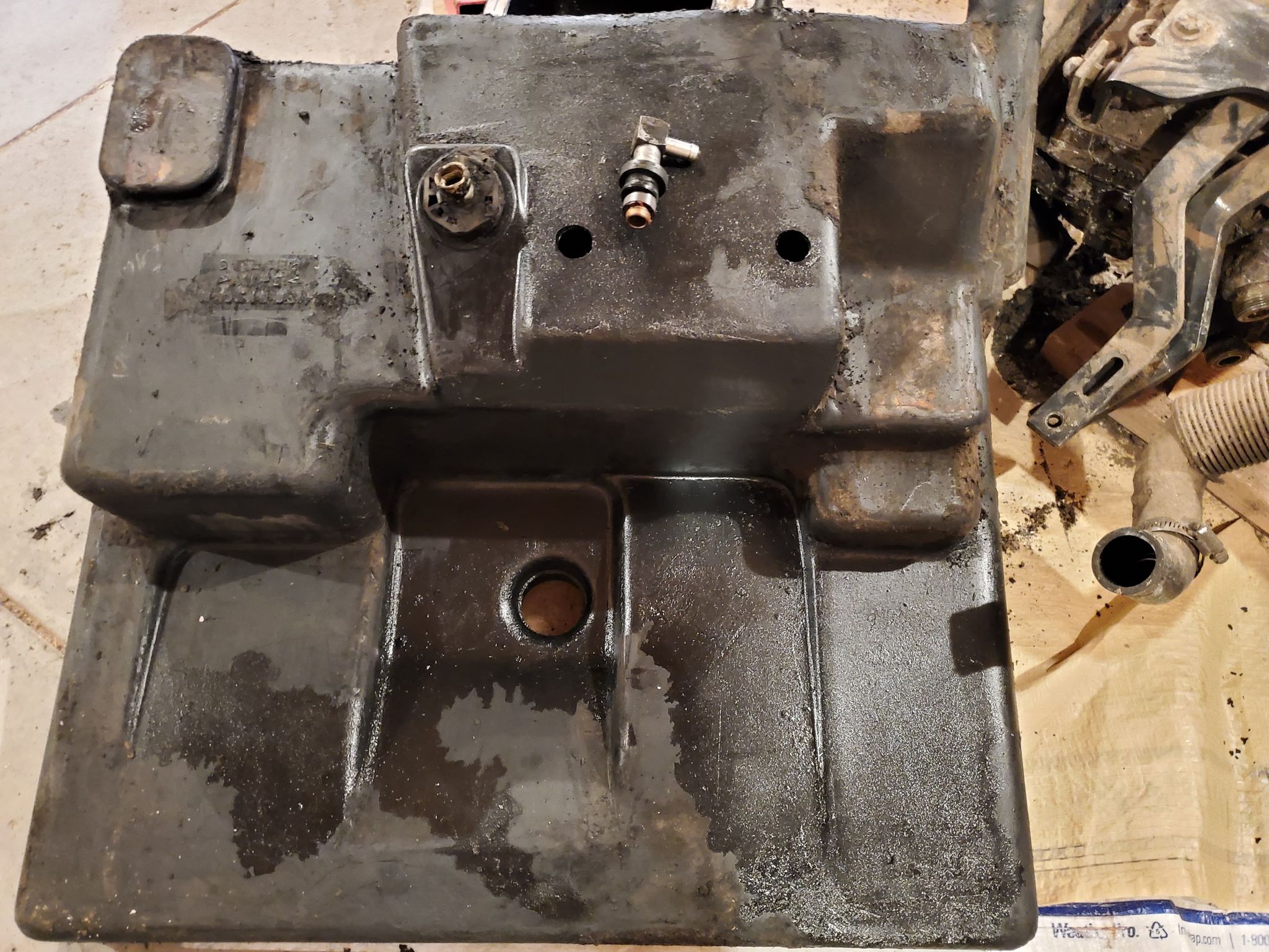

Hello everyone, looking for help. My bobcat wouldn't start, noticed the fuel filter primer bulb was soft. Changed the fuel filter, primed the system, would only start for about 10 seconds. Primer bulb soft again. Reprimed, same thing. The only way to keep it running is to keep pumping the bulb while some one starts it. The fuel shutoff solenoid reads 12 volts and I can hear it click when starting. I'm assuming I have a bad lift pump which is integral to the fuel pump as they are one unit that is no longer available. Local dealer thinks they can send out the pump to get rebuilt, I would have them do all the work. Am I missing anything here?
