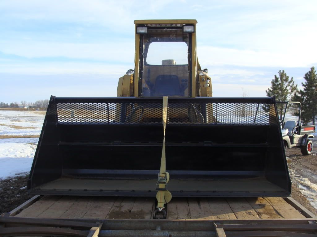

This is a snowbucket I had made and had finished by a local welding shop. I made the plans. Had them cut the steel. I tacked it together in my shop and they finished it off. I am in the process of painting it but I thought I would grab a few pics just to show you how it turned out.
the intention of this bucket was for it to be a how-to but then we got the X-mas blizzard here in ND and it turned in to a how-to-get-it-done-fast project.
The only mods we added to this vs a normal bucket are the viewing screens are 9" and on the back of the quick attach plate I had them weld supports through the steel to a 3x3 piece of tube across the whole inside.
The whole thing weighs in just under 1000# but I have yet to get a load in my ASV 4810 that won't go up easily.
