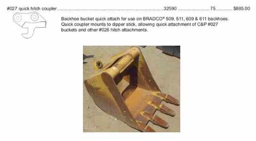

In a 2006 Bradco catalog, I did find the adapter below that allowed you to use C&P #26, and #27 style buckets. (Same as WAIN-ROY). But at $885 I wonder how many they actually sold?
