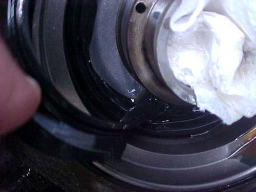

<blockquote data-quote="Tazza" data-source="post: 36153" data-attributes="member: 82"><p>I believe the O rings would have taken up that small amount of warp. The only parts you can flat palte are the end plates NOT the geroler (the part that the rollers fit in).</p><p>Just how warped are they?</p></blockquote><p></p>
