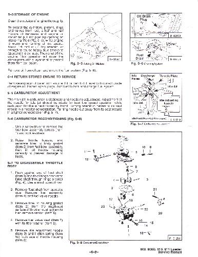

Okay my 600 is leaking gas from somewhere on the mechanical fuel pump. It did this once before and I tightened up all of the screws around the rim of it and then next time I used it it seemed to not leak anymore, but now today after use it started leaking again. I am wondering if it only does this when it gets hot. Maybe a small crack somewhere? Anyway,, does anyone know what info I need to bring with me for when I go to NAPA to get a gasket set? I assume a carb-rebuild set would have the fuel pump gasket? Should I just take off that bowl on the fuel pump and put some RTV on the seal? It is hard to tell exactly where the fuel is leaking from--it is a fairly constant drip/stream. Last time I went to NAPA I brought the engine model number, but he said that they needed the carb model number. However, does the fuel pump gasket get ordered off the carb number or off the engine number?
