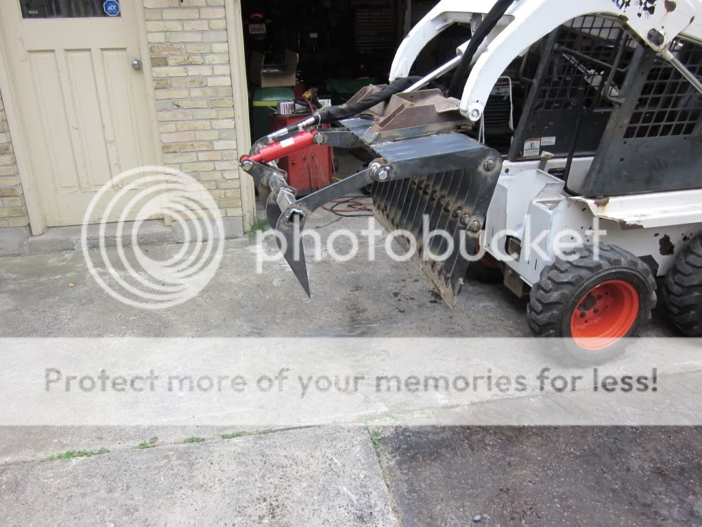

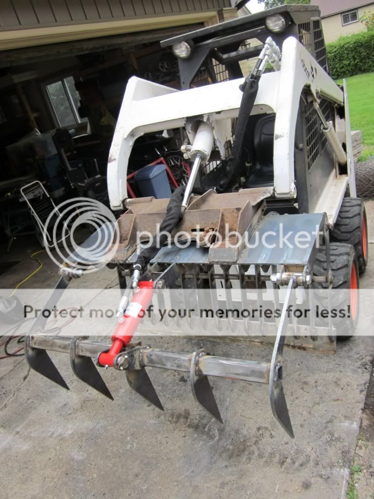

Here is a driver's eye view of the bucket in the "tweezer" position. I like the way the you can see through it to get a good view of what you are picking up.
I have had a chance to test it around the yard and I am very pleased with its performance so far.

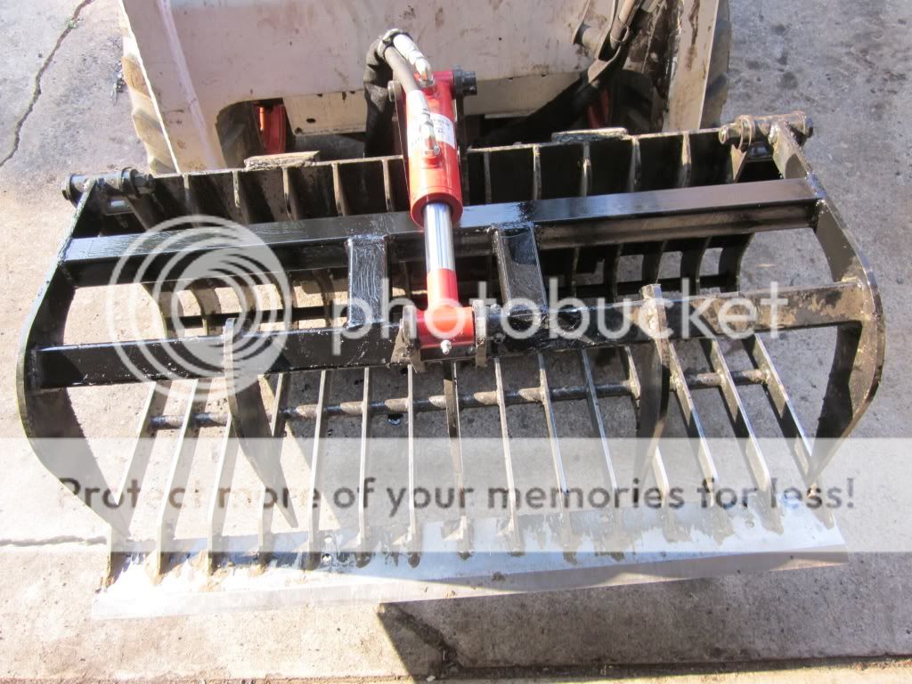

The bucket got christened yesterday. My sister and her husband are building a retaining wall on the edge of their property. I used it to break up some hard pan, sift out some rocks and rip out three medium sized tree stumps. This thing is really proving itself to be the swiss army knife of buckets. The Zamboni blade really slices through tree roots.
I did have a mishap though. While using the grapple teeth as a ripper, the grapple arm popped over centre, mainly because the main grapple tube was flexing. This was something that I was afraid would happen. I managed to kill 3 birds with one stone, by adding an additional crossmember and some bracing to the grapple frame:
Not only does the crossmember add more support, if it does try to pop over centre, it will make a hard stop against the base of the cylinder. It also helps to guard the cylinder from the load in the bucket

Very nice work man, I like how you set up the back plate to fit up the tines perfectly.
You ought to put a piece of 1/4 plate between those new cross members you added, to completely protect the crome shaft of the cylinder. It's only a matter of time before something comes through and nicks it up, especially if you grab a pile of scrap steel. Put some drain holes in it too, or a pattern of them if you want to see through it.

Hi nailsbeats,
Thanks for the feed back. Good call on the plate. I may keep my eyes out for a piece of HD expanded metal.
So far, so good though. I had to mess with the hydraulic hose routing a bit - the fittings kept coming loose - but I think I am past that now.
Other than that, it has been working incredibly well. I have used it to handle concrete slabs, logs, brush, lumber, ripped out tree roots, pried out cedar stumps, deck demolition, pulled concrete columns, lifted asphalt, peeled up sod, as well as using it to move around other attachments. Handiest bucket I own.
I added a removable counter weight to the back off machine to offset the weight of the bucket. It never ceases to amaze me what the little 440B can lift/do.
