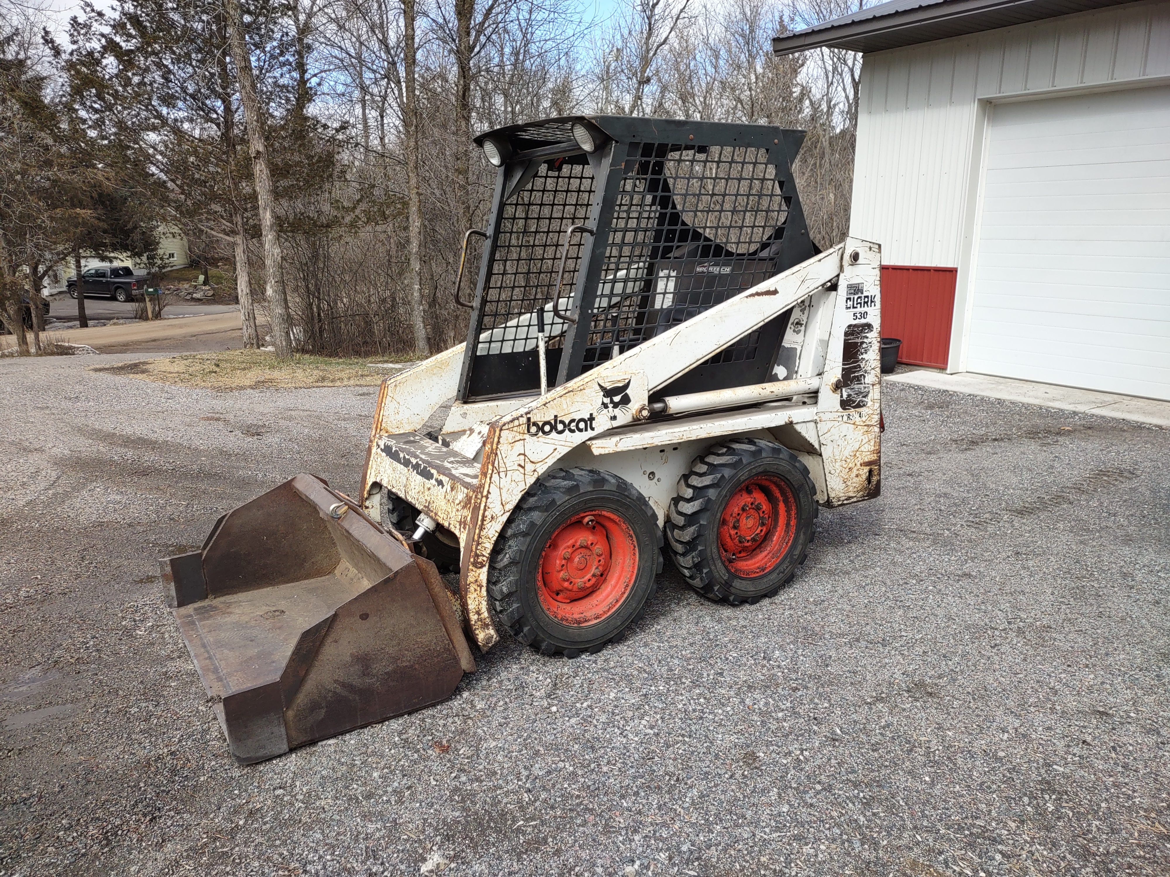

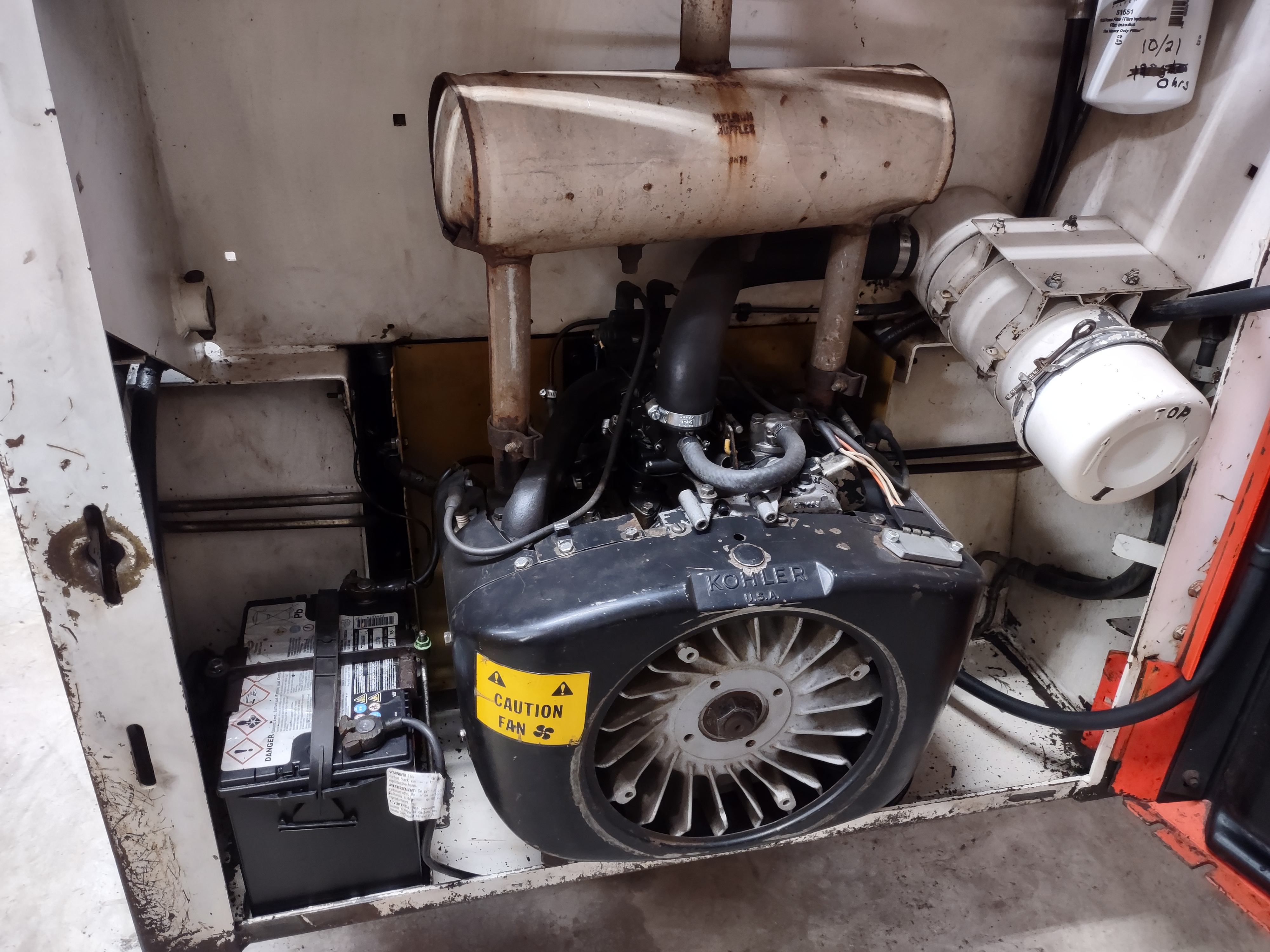

I picked this skidsteer up last summer. It's a Bobcat 530. It has a 23hp air cooled 2 cyl Kohler. It was in pretty good shape, so all I did was replace the seat and started using it. I've made a few mods and repairs since then. I bought some forklift forks and welded them to a quick attach plate. I added a backup camera which only cost me about $40 and a few hours work. The electric fuel shutoff solenoid failed, so I removed it and put in a manual fuel shutoff. I had a pretty bad hydraulic fluid leak that turned out to be and o-ring in one of the steering shafts going into the main pump. I had to pull the engine to do that repair. I discovered that the bolts holding the engine to the pump were completely missing, so it turned out to be a good thing that I had to dig in that deep to fix the leak.
I've got a couple more repairs on tap. I get some chain noise on the left side when go full speed. I think I need to tension that chain. The brake isn't working at all, so I need to look into that as well.

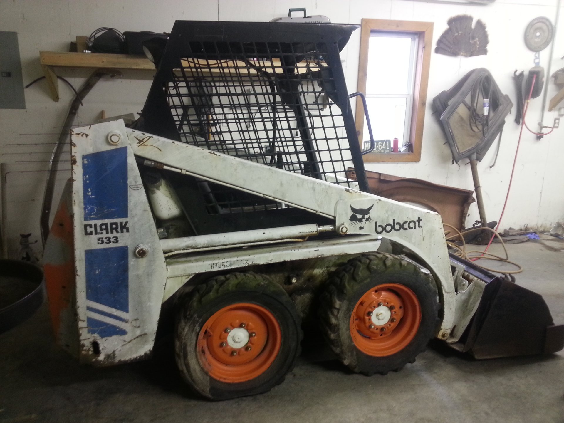

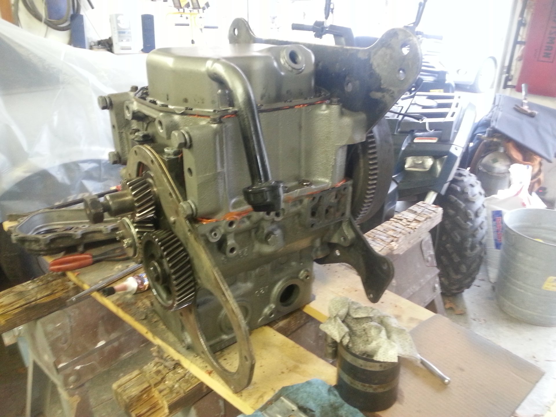

I have the same model except mine is a 533 2 cylinder diesel. I have rebuilt my engine and replaced some hoses. If you dont mind check out my thread I put on the other day and let me know if you have made ant repairs like this.

I had a hydraulic oil leak that behaved similar to yours. It would leak while sitting in my garage, but it didn't leak more when I was using the machine. It turned out to be an o-ring on the shaft that controls my forward/backward movement. I had to pull my engine to find it. I posted a video of that repair on my Youtube channel Fixing a Bobcat Hydraulic Leak . I also have an axle leak, but haven't gotten around to fixing it yet. My axle only leaks when I'm running my machine. Good luck on your repairs.

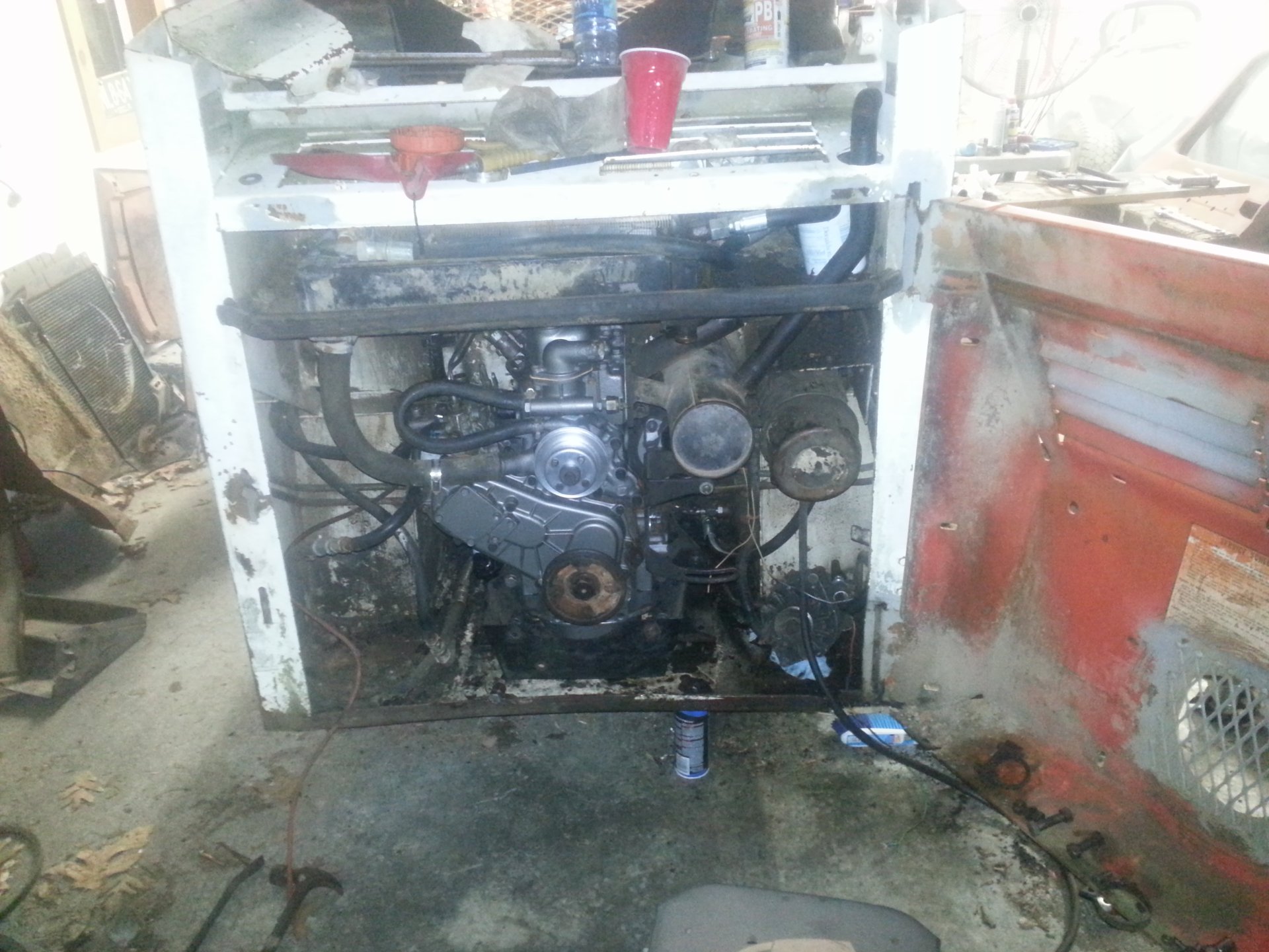

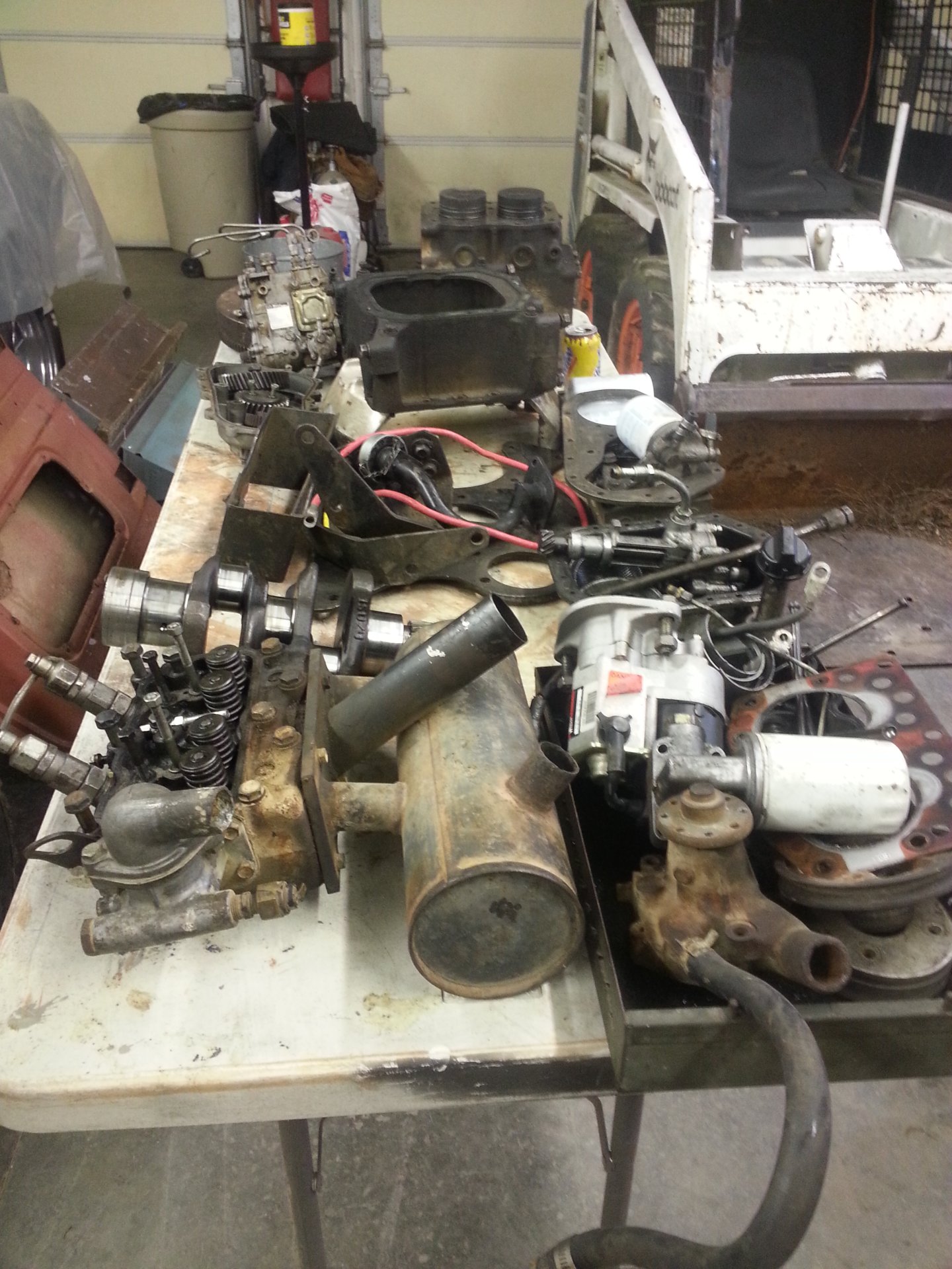

Great video. Not much info online about these smaller 530 and 533 machines. I will check my o-rings. I am in Missouri and been cold for awhile so my 533 been sitting a couple months. Big wet spot down the tire on LH rear axle. Guess Just going to have to dig in there. Bought mine off a guy that tore engine down and got bored with it. No compression. Engine was in boxes. Found rings and barrings from a couple different sources online. Took forever to find new injectors. Had head checked and rebuilt at a engine building shop. Got it all together and been good machine for around the house till the leaks. Here what I got when I bought it. before and after.

Hope your diagnostic and repair goes well. The 530 is really tough to work on due to tight quarters. Also, that large plate between the engine compartment and the rest of the hydraulics make it challenging to track down leaks. On the plus side, this model is pretty simple without the modern electronics.
