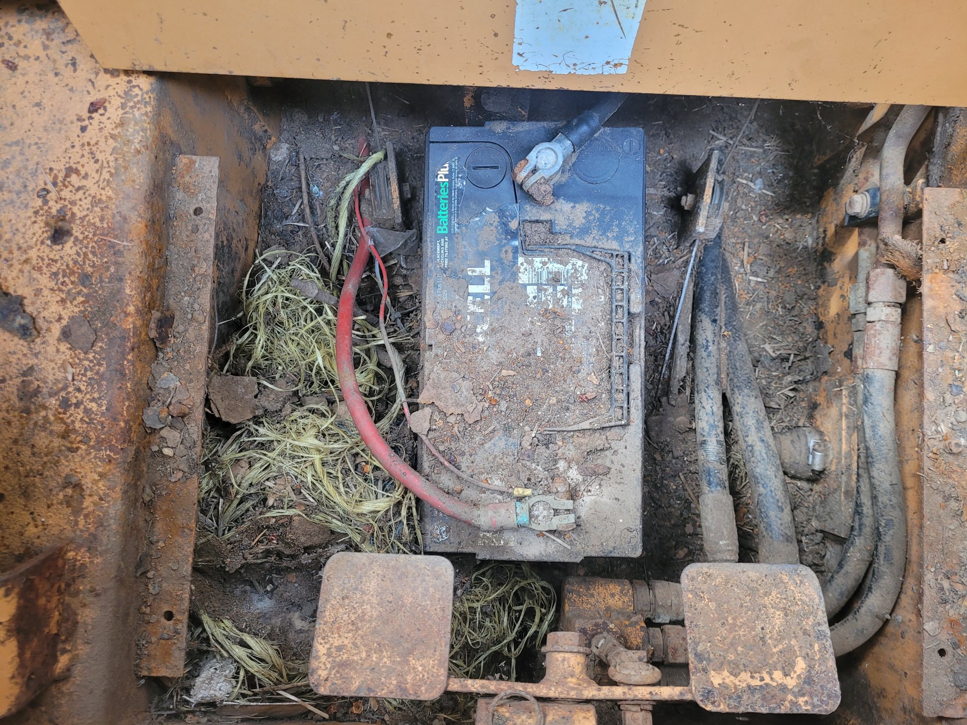

i got about a month ago at an auction for about $4200 . so i dont know what previously was its symptoms or problems. but i think it was left out in the weather for several years .when i got it had 6 inches of manure compost caked in the bottom, something was nesting in it. no coolant , flat tires, no hydraulic fluid , cracked fan belt , leaky coolant hoses. rotted out hydraulic hoses , shorted out and blown wires , the electrical panel did not work and did not even crank , and the controls were rusted in place frozen. alternator was trash , etc etc.etc...... almost suprised it even starts at all. . put in a lot of work last month and got everything functioning so far except for the fuel problem , hopefully the last problem .
mikweb73
Sep 28, 2022
3
a couple pics of it .
