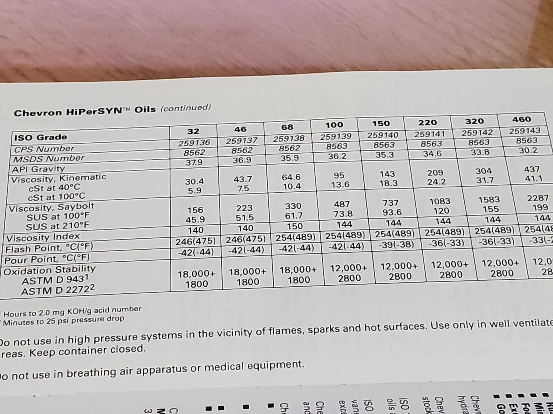

Any good hidrawlick oil will have an American Gear Manufacturer's Association (AGMA) rating. I have yet to see any motor oil with such a rating.
Here is an example from a Chevron/Texaco book.
It's been my experience to always go with the oil companies recommendations over equipment manufacturers mandates, as there are always marketing strategies involved. I worked in the oil analysis lab for the 13th Coast Guard district, assisted in the selection of chlorine free oil (CFO) for EMD engines that have silver bearing inserts, plus working with Caterpillar spec lubricants. I'm also a Chief Engineer.
