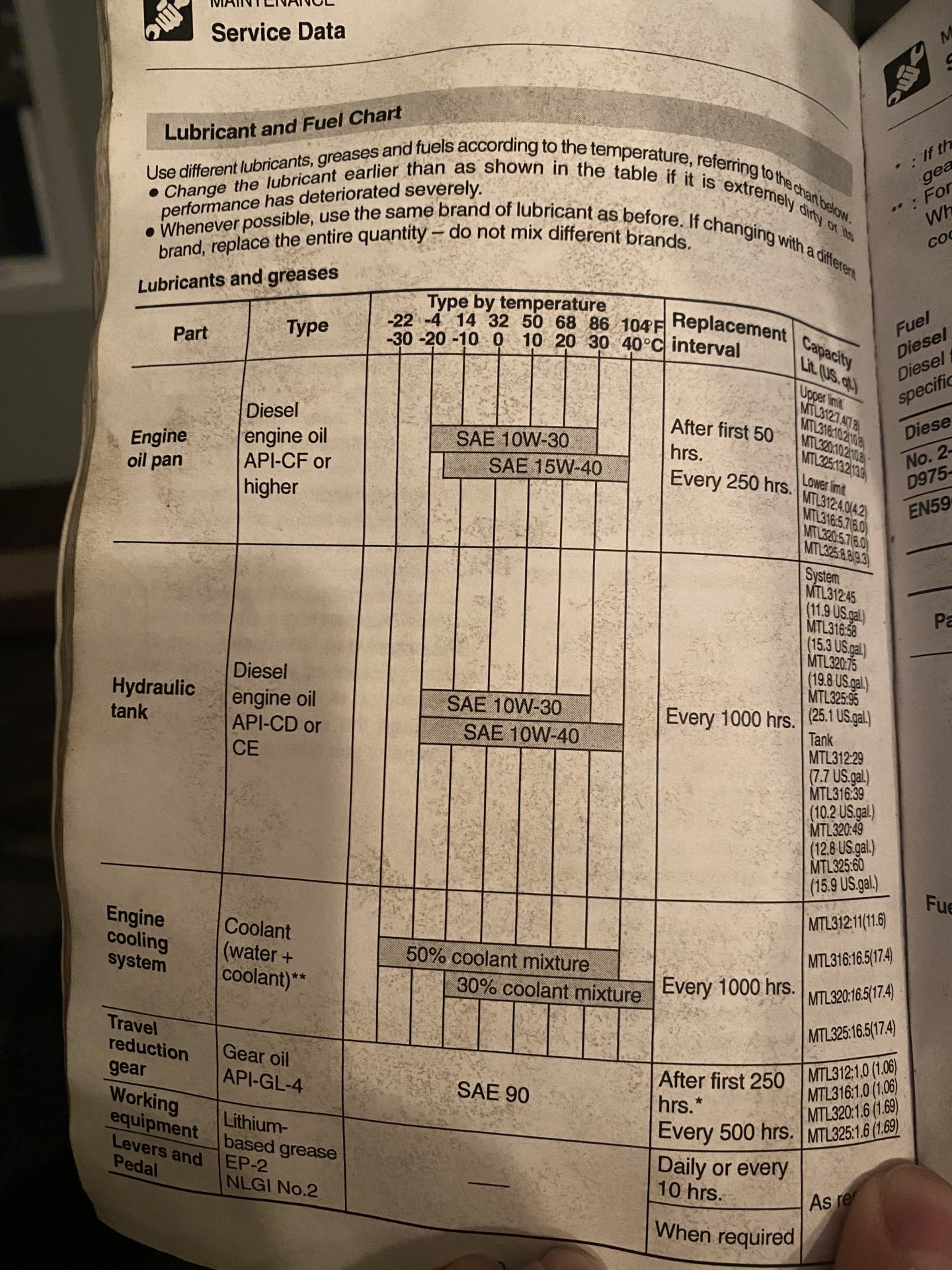

I found a manual jammed in behind the seat haha.

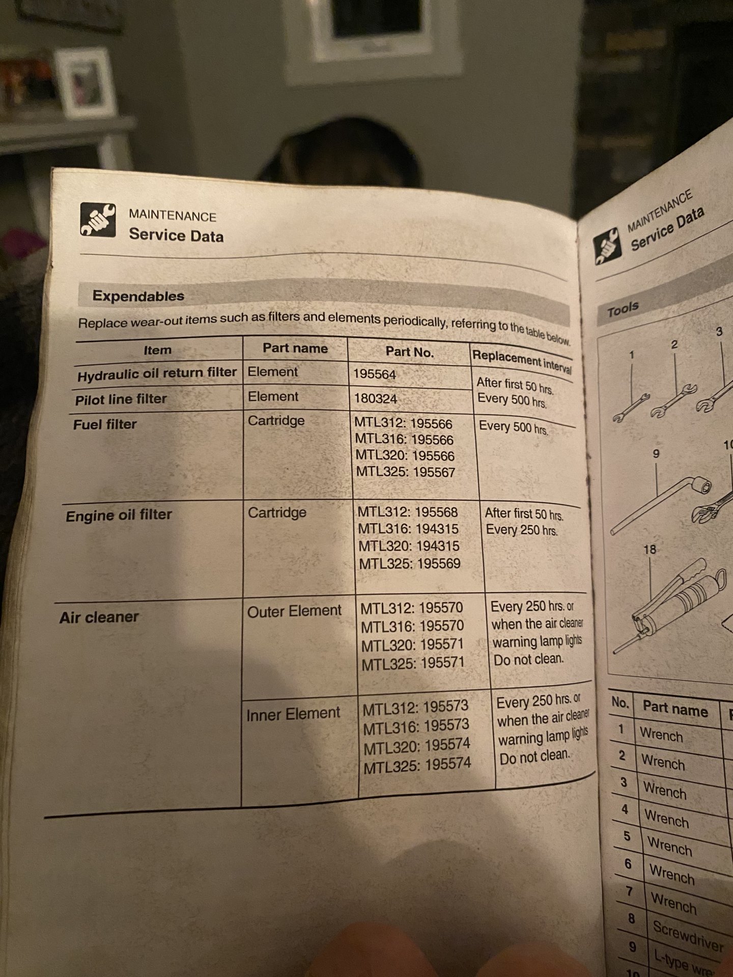

I am having a really hard time finding filters that cross over with the factory ones.

Why not just use the filter Gehl recommends? They are not that expensive.
I Googled "GEHL 195568 cross reference oil filter" and got good results.
