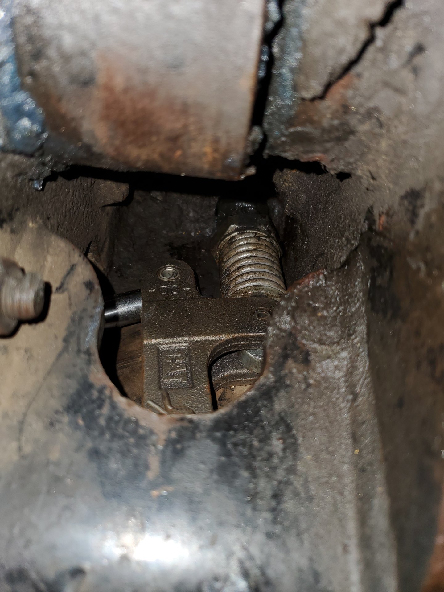

Just purchased a 2008 289c with quick attach. When using a GP bucket and loading weight on the tip or attempting to back drag, the bucket pops off of the quick attach. It looks like the pins slide up as if the springs are unable to hold tension on the pins. The pins extend fully when attaching the bucket and there is about 1/2" gap between the attachment plate and the bucket, but when you apply pressure to the tip, the gap grows and the pins slip up inside until the bucket pops off. I'm not quite sure what exactly the problem is or the cause of this. Any guidance on what we need to do to fix it would be greatly appreciated.
