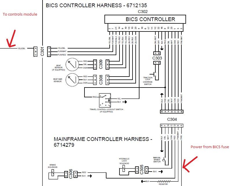

<blockquote data-quote="Pickuptrck" data-source="post: 78414" data-attributes="member: 11165"><p>The weather finally let up for a quick bit of monkeying under the hood. With everything plugged in, I get 6 flashes on BICS traction lock, all others steady green. When I unplug the 5-prong relaythat feeds it, I get a 1-flash change. With the relay plugged in and the solenoids unplugged, I still get 6 flashes so I'm assuming I have yet another short from BICS to the relay this time. The solenoid Bobcat sold me goes on the left side of the aluminuim block (with a spring loaded plunger), but the hoses that go to the wheels on a Tee are on the right?? Did they sell me the wrong relay? OM, I traced the wire causing all the former problems. It was a no-purpose wire added by someone in he distant past going up into the cab that had ground out on the ROPS cage. Thank you for your patience.</p></blockquote><p></p>
