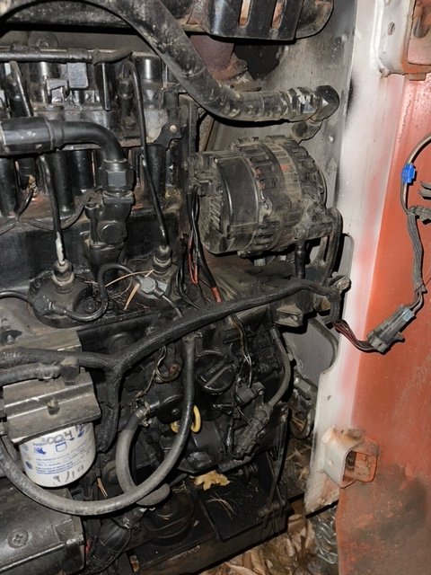

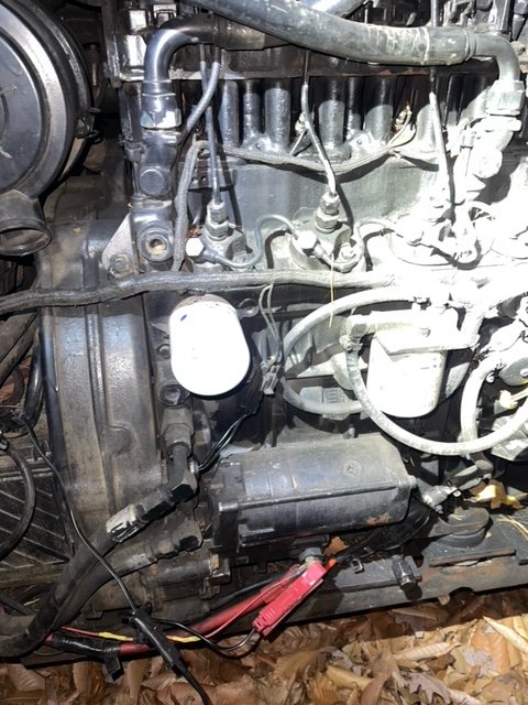

Jan 5, 2024 #1 J JaSong71 New member Joined Jan 5, 2024 Messages 3 I have an 873 that does not have an block heater that I can see. Where would the install location be? I am new at this, so please be kind.

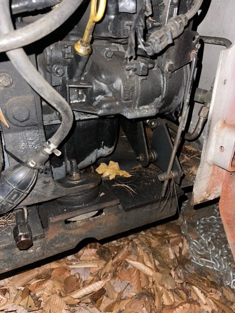

Jan 20, 2024 #3 P ProLogic New member Joined Jan 20, 2024 Messages 1 A VERY quick search online doesn't show a true block heater as the standard install. An oil pan heater is what is quickly available.

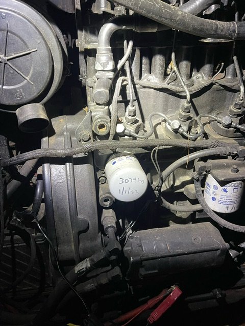

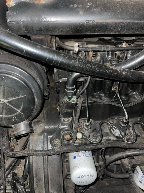

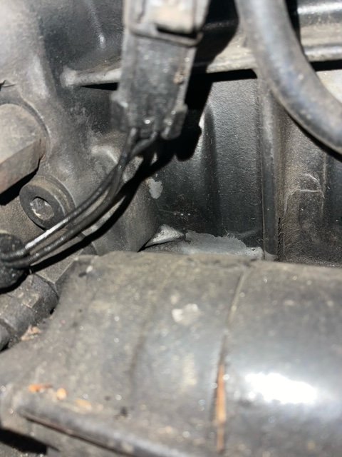

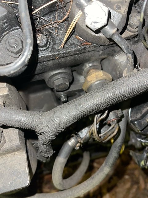

Jan 21, 2024 #4 R RC_Farms_377 Member Joined Jul 23, 2022 Messages 6 If you have the Deutz motor, then the oil pan heater is the preferred method? If so, I can post a pic of where the oil pan heater could/should be installed. Is yours a Model F or Model G?

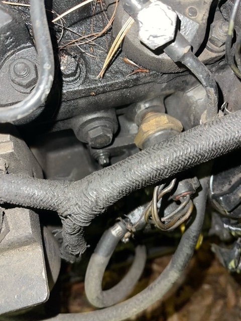

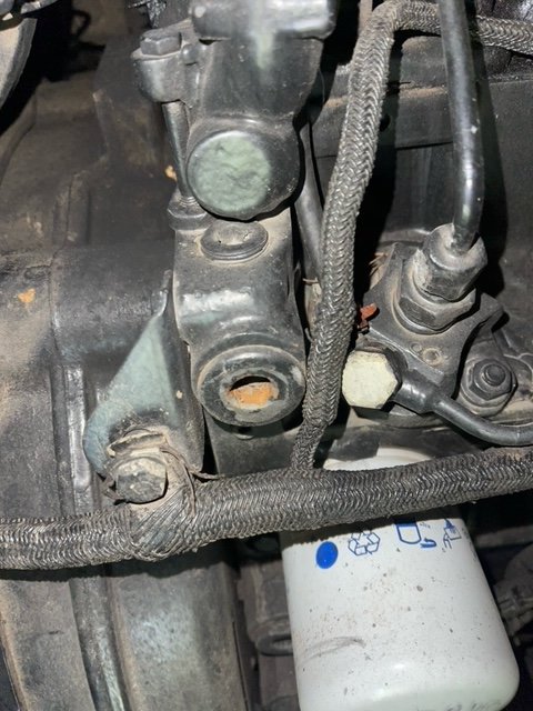

Jan 26, 2024 #5 S sethhe94 New member Joined Jan 26, 2024 Messages 1 Series F it's directly behind the starter.
